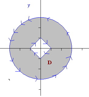

Hi there. I have the next exercice: Verify the Green theorem with the field [tex]F(x,y)=(x+y,2x-y)[/tex], and the path which its image is the boundary positively oriented for the region between [tex]x^2+y^2=9[/tex] y [tex]|x|+|y|=1[/tex]
At first I've drawn this:
Then I've parametrized the path
[tex]\lambda_1[0,2\pi]\rightarrow{\mathbb{R}^2}:\lambda_1(t)=(3\cos t,3\sin t)[/tex]
[tex]\lambda_2[-1,1]\rightarrow{\mathbb{R}^2}:\lambda_2(t)=(t,1-|t|)[/tex]
[tex]\lambda_3[1,-1]\rightarrow{\mathbb{R}^2}:\lambda_3(t)=(t,|t|-1)[/tex]
[tex]\lambda=\lambda_1+\lambda_2+\lambda_3[/tex]
[tex]I_1=\displaystyle\int_{0}^{2\pi}(-(3\cos t+3 \sin t)3\sin t+(6\cos t-3\sin t)3\cos t)dt=9\pi[/tex]
[tex]I_2=\displaystyle\int_{-1}^{1}[t+1-|t|+(2t-1+|t|)sg(t)]dt=3[/tex]
[tex]I_2=\displaystyle\int_{1}^{-1}[t+|t|-1+(2t-|t|+1)sg(t)]dt=-1[/tex]
[tex]\displaystyle\int_{\lambda}^{}F\cdot{d\lambda}=I_1+I_2+I_3=9\pi+2[/tex]

In the last integral I've made the change of variables [tex]y+x=u,y-x=v[/tex]. As you can see I have a problem with a sign, in the 2. Perhaps I should take the opposite signs because lambda2 and lambda3 are "negative" oriented? I thought the sign should came naturally given by the parametrization, so I'm not sure what I did wrong here.
I think you dropped a negative sign in this integral. The differential dy should be - sg(t) since y = 1-|t|.
And according to Mathematica, this change should make your line integral sync up with the double integral.
