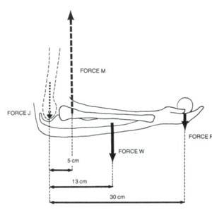

Google for "arm biomechanics". You need the the lever arm of the biceps, to compute how much force it must generate to lift a certain weight, at a certain distance:
Ignoring the forearms own weight it is about 6x times the load that you hold in your hand.

Thanks for that link; it seems to me that the length of the 'lever arm' between the elbow joint and where the biceps tendon attaches to the forearm is going to be proportionally shorter in a short-armed individual as well.
