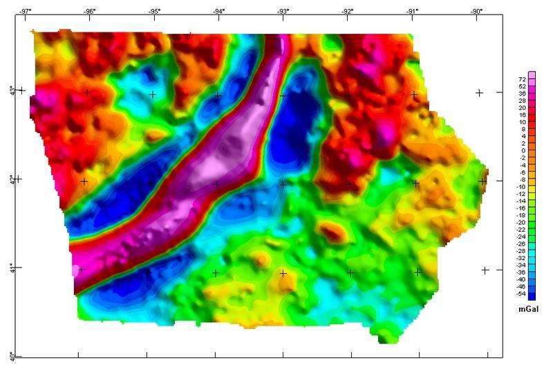

Dense rock such as basalt will result in anomalously high gravitation. Here's a false color gravity anomaly map of Iowa:
That ridge running diagonally across Iowa is a part of the (failed) Midcontinent Rift System. 1.1 billion years ago the North American plate started to split in half. That diagonal ridge results from the basalt that filled the rift as it was forming.
