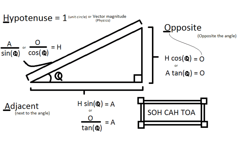

It is helpful to know trig as good as you can... You never know when it will come in handy, and it does a LOT especially in physics... I made this little dewhicky to help me when I was learning (still am learning), mostly for vectors in physics. All of the equations come from the original SOH CAH TOA.
