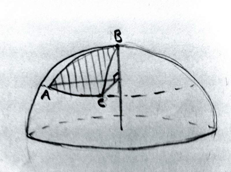

Well guys i have attached the picture so that you guys know what I am talking about. Now i want to find the surface area of triangle ABC while maintaining the current definition of the triangle in the diagram (i.e, AB is arc from a great circle, BC is an arc from a great circle and AC an arc from a small circle). Now I am trying to find the area that is shaded (ABC). Thanks for the explanation studiot, but can i still implement that method to finding the area of the shaded region in the figure attached?

Note that i would like to find the area of ABC that includes the area when AC is an arc of a small circle and NOT when we convert the arc between the two points AC to be of from a great circle bacause then the area would be different.
There seems to be some mixup between your description in words and your diagram.
As drawn
B is the pole.
BC, BA are arcs of great circles
AB is an arc of a parallel small circle or an arc of a great circle set at some angle to the pole.
What you need to understand is that these two arcs AB in fact trace out the smae path on the surface of the sphere.
They have different radii because their respective radii are measured in different planes. This is possible in 3dimensions, but not, of course possible in 2D
Thanks guys I have finally figured it out. Let's say the surface area above the region where points A and C are on is ω. Let's also assume that the angle subtended by the line both points A and B are on (as shown in my previous attached diagrams) is θ with regards to the base of the partial sphere and not the hemisphere. Thus the area ABC is equal to (θ/2π)*ω.
Where:
ω = π(c^2 + H^2) : - Formula for area of partial sphere.
-c -> radius of the base of the partial sphere.
-h -> height from the base of partial sphere to the top of the sphere.
π = constant pi
Thanks guys for all your assistance again.
