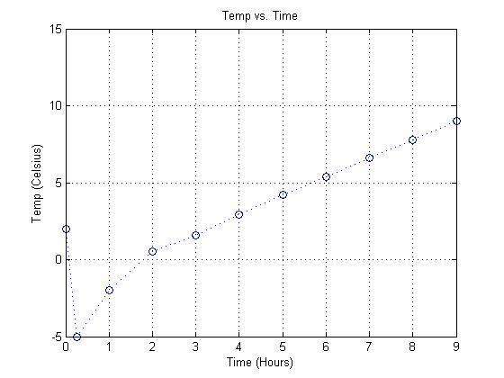

Okay so I did a triall run with a small cooler bag + Gel packs (2) and your predictions proved eerily accurate xts. See the attached plot. The temperature did bottom out at about -5 Degrees. Clearly there is a very steep drop in temperature at the start which will ruin my sample so now I am wondering what I can do about this. Specifically I am wondering what the impact will be if I now insulate the sample itself before placing it in the cooler between the two gel-packs?
I am hoping that such insulation will lower the heat transfer rate from the sample and thus smooth out the sudden spike down to -5 near time zero while minimizing the decrease in the overall time that the sample remains below 8 Degrees. Can this work ? Or will the entire plot just move up vertically if I isulate the sample before placing it in the cooler?

That is what I already adviced you: to insulate your sample. But you should not only insulate it, but also increase its heat capacity. It means: put the vial to insulating mini-box (mini-thermos) not alone, but together with some water of appropriate temperature (near upper limit acceptable for your sample).
I also advice to use melting ice rather than gel-packs. Gel-packs produce -5C, while ice only 0C. At the most dangerous moment, when your sample is just above its mininimal temperature +2C, heat flow to melting ice would be 3 times slower (temp. difference 2C) than to gel-packs (temp difference 7C).
