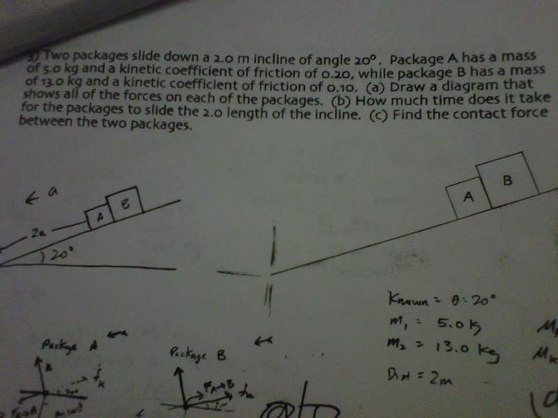

Is my solution for the acceleration of two blocks correct?

ckboii89
a= F/m
F= mgsinθ-Ffr
Ffr = [itex]\mu[/itex]mgcosθ
d= 1/2gt^2
a = (m1gsinθ+m2gsinθ)-([itex]\mu[/itex]m1gcosθ+[itex]\mu[/itex]m2gcosθ)/(m1+m2)
a = 3.72 m/s^2
t = 1.03s
I need someone to verify if this is correct, no anwser key was provided

ckboii89 said:
a = [(m1gsinθ+m2gsinθ)-([itex]\mu_1[/itex]m1gcosθ+[itex]\mu[/itex]2m2gcosθ)]/(m1+m2)
a = 3.72 m/s^2
t = 1.03s
d=
Take care with the formulation. The first term has to be divided by (m1+m2), too. Your result is not correct.
ehild
a=[gsinθ-(μ1m1gcosθ+μm2gcosθ)]
a=.298m/s^2
t=3.66
how about now?
a=.298m/s^2
t=3.66
how about now?
Still wrong. Did you divide the second term with m1+m2?
ehild
a=[gsinθ-g(μ1cosθ+μcosθ)]
a = 2.35 m/s^2
t = 1.30s
ck
a = 2.35 m/s^2
t = 1.30s
ck
Correct the red part.
ehild
[gsinθ-μ1gcosθ-μ2gcosθ]
ehild i really appreciate the help
is the contact force the difference between the forces of the blocks? or the sum
The contact force is the magnitude of the force one block exerts to the other.
The common acceleration is the sum of all forces on the system divided by the sum of the masses. The internal forces (the force of block 1 on block 2 and the one block2 exerts to block 1 are opposite and of equal magnitude) cancel, so a=∑Fi(external)]/mi.
If T is the contact force, Newton's second law applied to both blocks says that
m1a1=m1gsin(θ)-T-m1μ1gcos(θ) and
m2a1=m2gsin(θ)+T-m2μ2gcos(θ) .
If the blocks move together, a1=a2.
Add the equations:
a(m1+m2)=(m1+m2)g sin(θ)-(m1μ1+m2μ2)gcos(θ),
that is,
[tex]a=gsin(\theta)-\frac{m_1 \mu_1+m_2\mu_2}{m_1 +m_2}g cos(\theta)[/tex]
ehild
