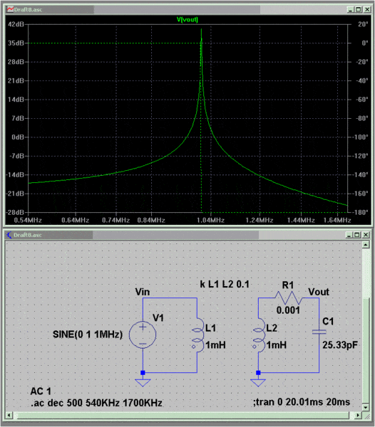

Here's an AC frequency sweep of a tank circuit as performed by LTSpice. The plot shows the tank signal amplitude (dB) and phase.
I still think we need to derive the transfer function for Vout/Vin in order to pinpoint the reason for the +/- 90° statement --- how does the circuit choose which it will be?

gneill said:
I may indeed be recalling the curve for something else. After giving it further thought realized that the transition would have to be smooth; For a very high Q tank the "region of resonance" can be very narrow
Yes, and as the OP was investigating the region of resonance with a dual channel oscilloscope, I expect the region of close interest would be just a few hundred Hz either side of the peak.
Thank you for going to all that trouble of a SPICE simulation. OP seems to have lost interest, but I haven't. :smile:
While I was thinking of an explanation for OP's observed +/- 90 degrees, I'd be more comfortable after first being assured it was an accurate observation, not the result of misuse of oscilloscope triggering.

I'd like to butt in here on account of (I believe) currently performing exactly the same lab and being irritated by the same question!
As the OP says, the circuit is an LC parallel tank driven by coupling from a nearby sine generator fed into an identical inductor.
At the frequencies investigated, the frequency generator impedance is negligible compared to the big ol' coil it drives so the Voltage at the first measurement (over the drive inductor) is lagging current by ~90 degrees.
The question is why, at resonance, is the voltage across the LC tank lagging (or leading, but I very much suspect lagging as it's a driven system) the voltage across the driving inductor by 90 degrees? It's unmistakeably the case, as the response amplitude did indeed peak at a +/-90 shift on the 'scope screen.
Since at resonance the L current is 90 degrees out of phase to the resonator Voltage, my suspicions would (wrongly!) have been that the phases would either match up or appear at 180 degrees... Hmm...
Does the weak coupling of the inductors have an effect? or is a 90 degree lead in magnetic field required for the first inductor to drive the resonator?
Alas I am stumped.
Back again for the benefit of future people having (I think) figured it:
To analyse this circuit, use the equivalent circuit for a transformer (http://en.wikipedia.org/wiki/Transformer#Equivalent_circuit") and neglect magnetising reactance and iron loss on account of the air core... Refer everything else to the primary and the result should be representable as a voltage source driving a series RLC circuit with some R, L and C (group them together) and the output taken only across the capacitor. Hence at resonance, the source sees an exclusively real impedance (reactances cancel out) so the source current and voltage share phase - but a quick complex potential divider equation will reveal the phase shift due to taking output voltage across the capacitor only!
