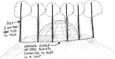

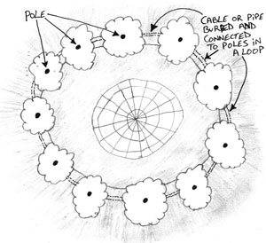

Idea 2 (More complex):
Snag a heap of second hand 2" to 4" diameter aluminium irrigation pipe (like a flag pole). Weld sections together to form a long pole close to the same height as the trees. Attach each pole along each tree trunk but not buried in the ground (not supposed to bury aluminium for lightning ground rods?). This would provide around 10-15 poles in a circle around the mountain top and the poles could be hidden from view by placing them on the side of the tree trunk away from the house. A thick copper cable (insulation stripped off), or a decent sized copper tube (thick water pipe?) would then be buried in sections, each end connecting to the aluminium poles to form a closed ring connecting all the poles at the bottom in the circle around the plateau. Possibly even sink in a copper ground rod between each pole and attached to the copper cable/tube for more ground contact.
Ideally, having the poles rise well above the tree tops would help insure the poles get hit before the trees, but again we face the council / aeroplane warning lights / eyesaw issues so we need to keep the pole tops below the tree tops.
I also thought of having the poles between the trees instead of leaning right up against them, but then we would have no tree support to hold them up and have to firmly anchor each pole in the ground and possibly provide a cable support at the top.
We really want to get away from making this thing seem like we are living in a cage.
I imagine that having 10-15 aluminium poles about 10-15 meters long each, and all connected together by a copper loop that is buried in the ground will provide an excellent, low resistance and very attractive path for lightening, even without the additional copper ground rods inserted between each pole for extra ground earthing to be sure.
However I wonder wether it will be enough, as right next to each pole is a very large electrical collector network (tree branches), though it will then have to go through a much higher resistance cable (tree trunk), but again is able to distribute the power into the ground through a very large Earth rod network (tree roots).
If we could provide a way to electrically couple the tree to the pole, may they be able to help each other? This page seems to suggest that the lighting would probably hit the tree first, go down the branches then jump to the pole (possibly just exploding the top part of the tree?): http://cr4.globalspec.com/comment/71350
Also, I am aware that special connectors will be required to join copper to aluminium, and that copper should not be placed above aluminium due to incompatibility of the two metals leading to accelerated corrosion?
One extra benefit of this much higher cost and effort design is that instead of using cable buried for the in-ground loop, we could run buried pipes to connect all the vertical poles and put sprinklers on top of each pole effectively doubling the system's use as a bushfire sprinkler system that surrounds the house. With the pipes full of water they are only likely to decrease the electrical resistance and this fire protection would help justify the effort.

A simple lightning arrestor on the highest point on the roof-top should suffice. In the 2nd case, the tree branches could outgrow the length of the vertical poles and reduce the effectivemness of the design. One would need to keep trimming the branches regularly to ensure effectiveness of protection. I personally feel the 2nd idea is a bit impractical! I think effective protection could be provided by methods much less extravagent then the ones suggested above...
P.S. Maintain Earth resistance below 1 ohm.

A simple lightning arrestor on the highest point on the roof-top should suffice. In the 2nd case, the tree branches could outgrow the length of the vertical poles and reduce the effectivemness of the design. One would need to keep trimming the branches regularly to ensure effectiveness of protection.I personally feel the 2nd idea is a bit impractical!
I wasn't thinking we would keep trimming the trees on design #2, if they kept growing then oh well, lightning may hit the top part of the tree first, then from what I understand would jump to the pole (lower resistance) to finish the journey to ground.
We might loose some of the top of a tree, but the main part of the trunk wouldn't take the whole electrical load.
Although many times more work and cost, the second design is appealing if we can double it as a bushfire defence system (the sprinklers would be spraying right into the tree canopy!). However if from a lightning point of view there is no benefit or is potentially even worse than 1 simple central rod over the house, then we could design a more appropriate separate bushfire system for less money and effort.

You believe I should not try to isolate the house structure from the ground, but I should completely isolate any "here I am, come and get me" lightning rods from the house structure? So the only way the 2 metal systems are connected is through the ground? That seems intuitive.
But I read in a large lightning protection manual that if your house / building steel frame was substantial enough, that you could connect the whole system together as there would be so many paths to ground through thick steel that it would all support each other for an even easier path to ground. But that made me wonder "what if I was touching the frame or was close to it when a strike hit"? Maybe the thick grounded steel is just too tempting for the lightening? Or maybe I could still get a wallop?
well i have to confess my prejudice about keeping lightning out of the house structure was based on premise the extremely high current can be destructive to the structure, as in wood.
maybe you have huge structural steel bridge beams or something - i don't know. i assume it's that light steel they use for house frames. if so,,,
i would not invite lightning currents to flow in my structural steel either.
instead encourage them to flow around the outside through cables dedicated to that purpose.
you do not want to be touching anything metallic while a lightning strike to it is in progress. (I base that claim on personal experience.)
think about it for a second - for duration of the stroke that metal is connected directly to the bottom of a lightning bolt. Charge moves out of the bolt and and along the metal on its way from the sky into the earth.
There is substantial voltage drop along the metal.
Indeed the voltage drop continues even across the ground itself, as that charge makes its way outward from point of contact(ground rod) and dissipates into surrounding earth.
You do not to be an alternate path for that charge. As you said, intuitive.
google term "faraday cage" -
imho you'd be better off making your house into a steel 'faraday cage' that does not have to handle the kiloamps of the lightning stroke itself , only the smaller induced currents caused by its proximity.
So i'd do a little overkill on the lightning rod grounding electrodes and keep an eye toward encouraging the lightning bolt currents to go around and away from the structure.
most lightning is in the range of ten to a few hundred amperes and doesn't even bother thin aluminum aircraft skin.
thirty kiloamps is a whopper but not unusual in severe thunderstorms
and there's monsters in hundreds of kiloamps.
