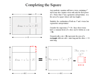

You might be interested in the geometric interpretation - completing the square really IS completing the square!
(I had to do some serious editing and compression to get it to fit - hope it works!)
