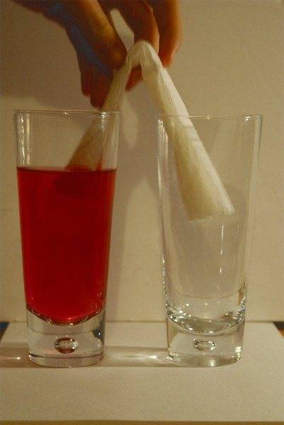

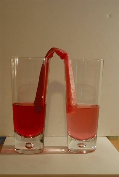

I know there have been a number of posts relating to capillary action but after reading through them I cannot find an obvious answer to my query. Although capillary action can be used to explain the properties of 'wicking' materials that can raise water vertically I am unsure as to whether it is possible to collect that water at a point higher than it started. To illustrate I have done a number of common experiments such as a paper napkin or paper towel siphon from one glass to another. (see images attached). Eventually the water level in each glass will equate. If you then raise one end out of the glass will it continue to drip? Everything I have read would suggest no, in order to do this the surface tension would have to break (as I understand) and it is suggesting a continuous flow of water may be possible. However in this article http://drspark.com/idea001.php" the author claims to have set up an experiment where water can be sucked up a capillary tube into a wicking material and leave at a higher point than it started. This would seem to me to break the rules of energy conservation and therefore not be possible unless there is something I am missing. I would be really grateful for any comments, I am an architecture student looking into the properties of wicking materials for the design of a pavilion that could provide evaporative cooling and thermal mass. As it is a short theoretical project I don't have enough time to fully explore but for my own interest I would like to understand whether this potential for perpetual water flow is possible or not?

No, it isn't. There are many threads on this, I'll try to dig it up.
Something dodgy about that video. Trees move water up to the leaves by capillary action, where most of it evaporates from the leaves. It's the evaporation that draws up more. So long as you are content for the liquid to be evaporated, capillary action allows you to raise it up higher-that's what a wick does. The tree trunks are full of very very thin pipes in which the water rises. On a hot day, it is said that a microphone placed on the trunk of a tall tree can hear the pings (or reverberations) as the thread of water in individual pipes regularly breaks when the "suck" exceeds the force of attraction between the water molecules and a vapour lock momentarily forms, then repairs itself.
Thanks for your replies, I agree that the video doesn't look quite right. I found a further reply by the author suggesting that the wick they hung from the top of the capillary tube was long enough so that a drop forming on the bottom of the wick would just touch the surface of the water below which would then draw out the water from the wick. However I am not sure that it is even possible for drops to form at the end of the wick. What I was initially planning was an experiment where water could be wicked from one bottle to another above (see attached image), this would be repeated up the structure however I believe some form of pump will be needed in the end.

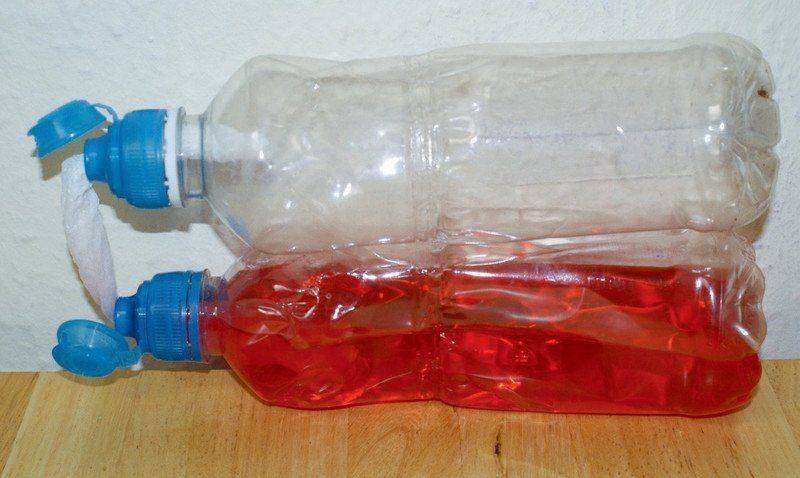

@NascentOxygen - I think the evaporation could really help, however I would also be interested in the effects of temperature differentials and pressure differentials however this starts to look more at fluid dynamics and bernoulli's equations. I would be really interested to look at more detail on the tree structures to see if that sound can actually be heard?

Your two bottle demo may appear to cause water to move upwards. The mechanism might be that a small amount of the vapour is captured in the upper bottle and condenses back into water. Is the condensate red or clear? What percentage of the loss from the lower bottle is captured in the upper bottle? You could try wrapping plastic tape around the exposed wick, or enclose it in sealed plastic tubing, to eliminate evaporation losses and see what happens. :smile:

This would seem to me to break the rules of energy conservation and therefore not be possible unless there is something I am missing. I would be really grateful for any comments, ?
There is no need for energy conservation to be violated. There is a constant supply of thermal energy from the room which can provide the Latent Heat of Evaporation for the water and any other energy needed to lift (select) a small proportion of 'energetic molecules' inside the column. I suspect that, if you conducted the same experiment in a sealed, insulated container with no light or other radiant energy admitted, the phenomenon would slow down or even stop once the humidity gets high.

Btw, that 'syphon' is a very common phenomenon. If you hang a cloth over the lip of a bucket, nearly full of water, it will often just empty the bucket, dripping onto the floor, if the initial ' lift' is not too high and starts off the syphon action.
