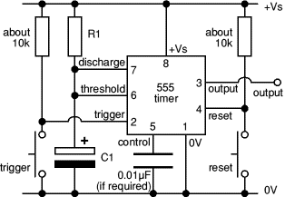

Hello experts!
I have given 2 question in exams.
1)Explain why duty cycle of Astable circuit's output is always greater than 50%?
2)In monostable multivibrator, how low does the triggering voltage have to go in order to initiate the output pulse and why duty cycle must be greater than 70%?
What could be the answers to these question. I have given exams. I just want to review my concept.
Here are two Astable schematics; One diode in which we get 50% duty cycle. And other without diode.
Here is also monostable schematic.
Thanks in advance.

you should present your answers and why you think they are right, and if anyone notices an error, they will let you know.
The timing capacitor charges through both resistors, but only discharges through the lower one (into the 555's discharge pin, pin 7).
So, the charging always takes longer than the discharge and the output is always high for longer than it is low.
Adding a diode a shown in the second diagram would reduce the charging resistance and allow a faster charging time than discharging time.
The monostable comment is not true as far as I know. You could trigger a monostable for 1 second and then not touch it for an hour. This would give a very short duty cycle.
Duty cycle doesn't really apply for monostables.
The triggering input on a monostable is normally grounded for triggering. According to the data sheet for the 555, a minimum voltage of 0.33 volts is required for reliable triggering.

Here are my answers.
1)TCharge=C1(R1+R2), hence charging is through both resistors. While Tdischarge=C1R2, hence discharging is through just R2. This implies clearly that charging is always greater than discharging.
2)In order to initiate pulse at output pin2 is below 1/3VCC then we get output high. But why its duty cycle must be greater than 70%, I don't know. But I want to know answer. Help please. thanks
Look at my answer which I have given at phinds objection. And help me by looking that. Thanks.

No. Can you see that R1 + R2 has to be greater than R2? Assuming R1 is not zero ohms.
So, the time the output is high has to be greater than the time that it is low.
Duty cycle is the ratio of time that the output is high compared with the time that it is low.
There is no reason that this would be more or less than 70 %.
You could trigger a new pulse immediately after the old one has finished or you could wait a week before triggering a new pule.

No. I mean to say that...
Let meets an example,
Let C1=0.01μF and R1=10k and R2=100k then Tcharge=1.1ms while Tdischarge=1ms
Now, let C1=0.01μF and R1=10k and R2=10k then Tcharge=0.2ms while Tdischarge=0.1ms
Now again, let C1=0.01μF and R1=100k and R2=10k then Tcharge=1.1ms while Tdischarge=0.1ms
Did I do all cases above correctly? If so then without diode in each case I get duty cycle must be greater than 50%. Am I right?

In monostable is not necessary duty cycle is greater than 70%. Then why my teacher give me that question! Seems strange.
But idea of triggering is still not clear to me. Because charging is depend on discharging in monostable i.e. if capacitor discharges to 1/3Vcc then at that moment I have to given an another pulse to generate output pulse. Isn't it?
Yes, the duty cycle is always greater than 50%.
You could ask your teacher that question. Maybe he means something else.
Duty cycle is really only applicable to a repetitive waveform, not to the random nature of a monostable.
The capacitor starts off uncharged because it has a conducting transistor across it and then the internal transistor on pin 7 switches off and the capacitor starts to charge via the series resistor. This takes time and during this time, the output is high.
When the capacitor charges to 0.66 * V+ then the output goes low again and the capacitor is discharged via the internal transistor.
