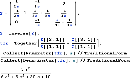

I've ran into this rather peculiar circuit. In all the circuits I've seen (as far as transfer functions go), Vout has always referenced ground (e.g. one node of Vout is ground); in this one, however Vout is across an inductor. I've attached the circuit diagram. (excuse the crudeness of the circuit diagram...quickly whipped it up on Paint :rolleyes:).
Find the transfer function Vout(s)/Vi(s) of the circuit.
R=1Ω, L1=2H, L2=3H, C=0.1F
Zr = R; Zl=Ls; Zc=1/Cs; KVL; KCL, etc.
Since Vout wasn't referencing ground, I figured that I needed to use the mesh-current method to get equations for Vi and Vout for each loop. After some rather nasty symbolic matrix algebra, I got expressions for I1 and I2 (loop currents), plugged each of those back into the mesh-current equations, and obtained:
[itex]H(s)=\frac{V_{out}}{V_{i}}=\frac{3s^2}{6s^3+5s^2+20s+10}[/itex]
Is this correct? Also another question: is there a simpler way to do this? Forgive my idiocy but I might be missing something terribly obvious...

Your solution looks good. Your method is fine too.
Nodal analysis also works well for these transfer function problems. See the image.

Sounds good! Thanks a lot guys.
-Leo.
I too can corroborate your answer as being correct. Happy days!
