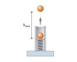

Here's the question:
"A spring-loaded toy gun is used to shoot a ball of mass m straight up in the air. The spring has spring constant k. If the spring is compressed a distance x_0 from its equilibrium position and then released, the ball reaches a maximum height h_max (measured from the equilibrium position of the spring). There is no air resistance, and the ball never touches the inside of the gun. Assume x_0<<<h_max."
"Find , the muzzle velocity of the ball (the velocity of the ball at height above the equilibrium position). Express your answer in terms of given quantities."
I tried v = sqrt(2g(h_max-h)); but it didn't work.
I'm not sure if I should try v = sqrt[((kx_0^2)-(2mgh))/m], since the question suggested me after my first answer that g, h_max, and h are not relevant variables - in the past, for some weird reasons, the generic variables that are not given in the question worked.
Please help!
Another question is finding h_max; if h_max is not related to the previous question then how am I suppose to find it.
Thanks in advance,

BTW, these were the conservation of energy equation I made
(1/2)kx_0^2 = (1/2)mv^2 + mgh = mgh_max
The first end was only (1/2)kx_0^2 because x_0 <<<<< h_max
Please help
Thanks in advance,
Where did I go wrong?
Since the spring does work against gravitational force to bring the ball a distance [tex]x_0[/tex] higher, you can consider the spring has done [tex]mgx_0[/tex] of work. Therefore, by using the method of conservation of energy, your equation should be:
[tex]\frac{kx_0^2}{2}=\frac{mv^2}{2}+mgx_0[/tex]
You can approach the question by using the integration method as well. First,
[tex]F=-(kx_0-mg)[/tex]
[tex]ma=-kx_0+mg[/tex]
[tex]v\frac{dv}{dx}=-\frac{k}{m}x+g[/tex]
[tex]\int(v)dv=\int(\frac{k}{m}x+g)dx[/tex]
This method also yields the same answer.
To find [tex]h_{max}[/tex], you have to make use of the velocity you found in the first question. Equalling the kinetic energy at the equilibrium point to the potential energy at the highest point. There will be no kinetic energy at the highest point, the velocity of the ball is instantaneously zero at that point.

Two problems:
(1) The muzzle velocity is the speed of the ball at a height = 0 above the equilibrium position, not h.
(2) h_max is not given, it's just the label for the maximum height. So you can't use it to represent your answer.
To find the muzzle velocity, use the energy conservation method that CartoonKid gave:
Since x_0 << h_max, the mgx_0 factor may be ignored:
[tex]\frac{kx_0^2}{2}=\frac{mv^2}{2}[/tex]
Use the exact same method, only now have all the spring PE go to gravitational PE (set KE = 0):
[tex]\frac{kx_0^2}{2}= mg(x_0 + h_{max})[/tex]
Again, since x_0 << h_max, the mgx_0 factor may be ignored:
[tex]\frac{kx_0^2}{2}= mg(h_{max})[/tex]

Thank you so much Doc Al and CartoonKid :smile:
They actually ignore x_0 :rolleyes:
