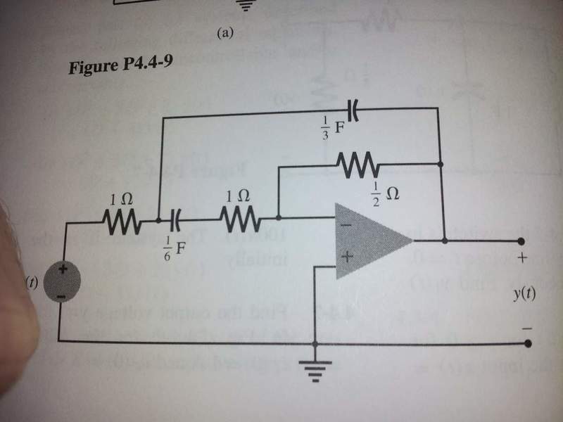

I need help finding the transfer function for the attached image.
I combined the 1/6F cap and the 1 ohm resistor into a single impedence. I know the AV of the opamp is -0.5/(6s+1). After that I am stumped.
Is there a name of this specific circuit?

Have you tried nodal analysis? Call node "a" the junction of the input 1Ω resistor and the capacitors, call node "b" the inverting input of the op-amp. The output of the op-amp can be Vo, while the circuit input signal is Vi. Remember the properties of an op-amp; there's a negative feedback loop, so what can you say about the voltage at the input terminals? How about the current?

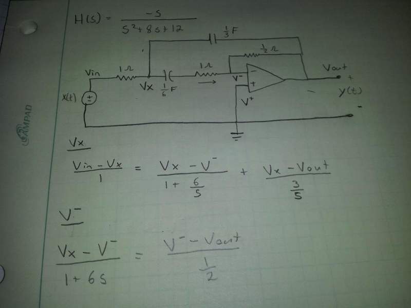

Ok, I know I am on the right track. I have tried a couple things, but didn';t quite get it. I guess my problem is relating V- to V+. I want to think that V- = V+ = 0, but I don't think that's right. I know the answer (it is at the top of the sheet). Here is what I have so far now.

I got it :) Thx anyhow! Little bit of patience and practice pays off
