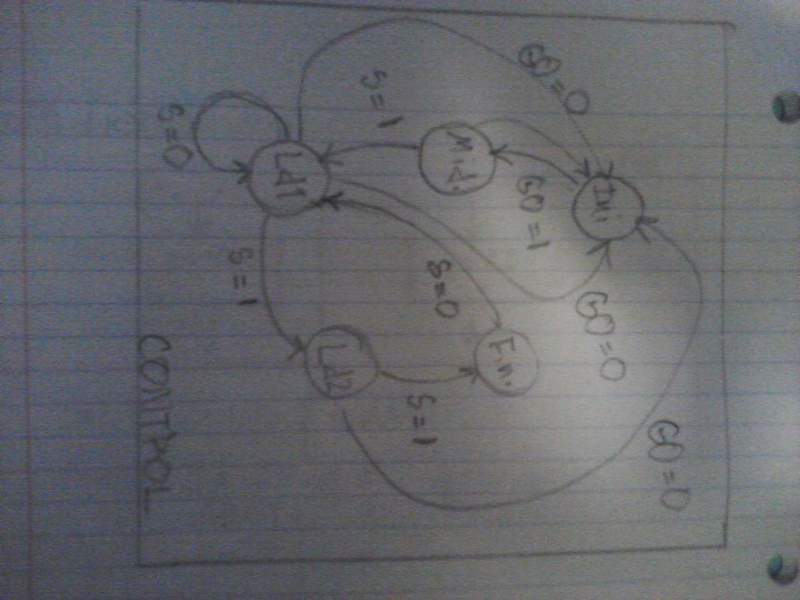

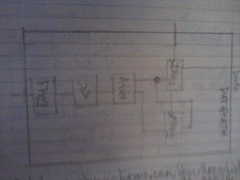

Here is my current work. Sorry about the bad quality but that is all I have. In the mean time I will google set up time and hold time. I think I have to get rid of the last register (output register). For the datapath image the boxes that are NOT the shifter and adder are registers.

After some reading and researching I think I got the answer to :
how do the setup and hold time specs relate to the maximum clock frequency of your solution?
The setup time should be enough for the byte to travel to the gates of the register (or the register to read the data) and the hold time should be enough for the data to be stable and pass through the register (or the register to act upon data).
