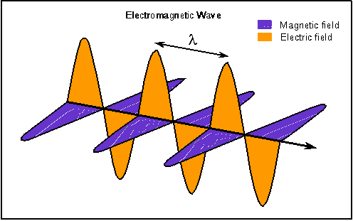

A nice effort, and pretty good introductory tutorial. I only have small issues with it -- like the fact that by convention, current flows from positive end of the battery to the negative (even though the actual charge carriers, which are negative, flow in the opposite direction). Also, some of the animations could be misinterpreted, like the expanding circular arrows emanating from the single moving charge. The interlinked circular arrows representing the EM field are unusual and in that context I'm not sure what they are supposed to represent. The conventional depiction of a plane EM wave generally shows the electric field oscillating in one plane and the magnetic field in a perpendicular plane, so nothing is actually rotating, I think.
Here's the first depiction that popped up in Google:
But all in all, a great effort. Thanks!

I thought a long time about how to handle representing the direction of the current. If I used the conventional direction of flowing from positive to negative, I would actually be showing an erroneous picture of what physically happens. So, I decided to go with what is physically correct, as opposed to what is conventional.
As for the interlinking circles representing the EM wave, if you think about it, they are the same thing as the commonly drawn waveform which you posted. I drew it the way I did so that people could relate it to the material which had been presented in the video previously. Also, in my opinion, the way I drew it is a more intuitive way of thinking about it, with each changing electric/magnetic field in the chain inducing the next one.
