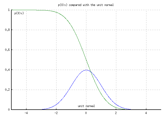

So how would you go about proving for example that
P[X>x] > f(x)
if you're given some f(x)
I would use a numerical method - fastest.
The exact method used will be determined by the purpose of the exercise.
eg.
... see, easy. Took about a minute.
A student would be expected to be clever and use their knowledge of the properties of f(x) and the gaussian, their relationship etc. For example, if f(x)=-x2 then it will always be negative while p(X>x) is always positive. In the image, if f(x) is the unit normal, then the proposition is easily disproved.
I am guessing that it is the absence of an indefinite integral that bothers you?
As you'd expect, this is a very well studied class of functions. Approaches for dealing with them are very well documented - eg. in the links I gave you. In general one uses numerical methods or approximate-analytic solutions or combination - these can be made as accurate as needed.

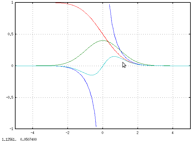

From private communication: (sorry dude, but it benefits most people to do this in public)
[tex]\frac{1}{\sqrt{2\pi}}\frac{1}{x}\exp{(-\frac{x^2}{2})} > p(X>x) > \frac{1}{\sqrt{2\pi}}\frac{x}{x^2 + 1}\exp{(-\frac{x^2}{2})}[/tex]
... realizing that x > 0.
Observe that: [tex]p(X>x)=1-p(X<x)=1-\text{erf}(x)[/tex]
I'd approach this by exploiting the properties of the curves.
Notice the std unit normals in there?
Denote the std normalized unit gaussian as n(x), and rewrite:
[tex]f(x) > 1-\text{erf}(x) > g(x): \qquad f(x)=\frac{1}{x}n(x), \qquad g(x)=\frac{x}{x^2+1}n(x)[/tex]
... the curves are: blue: f(x), cyan: g(x), red: 1-erf(x), green: n(x)
A strategy suggests itself:
f(x) approaching x=0, is assymptotic, thus >> 1-erf(x)
as x gets big, f(x) approaches 1-erf(x) from above.
since they are both well behaved, f(x)>1-erf(x) in the whole domain.
g(x) has a global maximum by x=0.3 which is less than 1-erf(x) there, and g(x) only gets smaller from there. As x gets big, g(x) approaches 1-erf(x) from below.
So it looks like you want to know the shapes of the functions in the limit as x gets big.
Probably someone else can do better.
