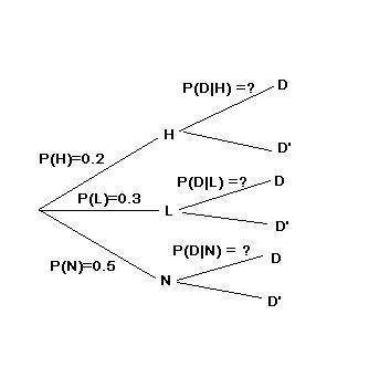

Hello again!
I'm stuck and need a little push.
Referring to the diagram: out of a group of smokers, 20% are heavy smokers, 30% are light smokers, and 50% are non-smokers. A light smoker is twice as likely to die as a non-smoker but half as likely as a heavy smoker.
H: heavy smoker
L: light smoker
N: non-smoker
D: die
So, I created the tree diagram (see attached) and understand the relationship. I come up with the following.
[tex]P(D|L)=2P(D|N)=\frac{1}{2}P(D|H)[/tex]
[tex]P(H|D)=\frac{P(H)P(D|H)}{P(D)}[/tex]
and likewise for P(L|D) and P(N|D)
I need to figure out what P(H|D) is given the info and the tree I created.
Can someone nudge me in the right direction?
Thanks,
dogma
waiter...check please
I think I got it…can someone check me, please?
The probability of a person being a heavy smoker given that he died:
[tex]P(H|D)=\frac{P(H \cap D)}{P(D)}=\frac{P(H)P(D|H)}{P(D)}[/tex]
The probability that a person in this study dies:
[tex]P(D)=P(H \cap D)+P(L \cap D)+P(N \cap D)[/tex]
[tex]= P(H)P(D|H)+P(L)P(D|L)+P(N)P(D|N)[/tex]
…but since [tex]P(D|L)= 2P(D|N)= \frac{1}{2}P(D|H)[/tex]
…so
[tex]P(D)= P(H)P(D|H)+\frac{1}{2}P(L)P(D|H)+\frac{1}{4}P(N)P(D|H)[/tex]
…then
[tex]P(H|D)=\frac{P(H)P(D|H)}{ P(H)P(D|H)+\frac{1}{2}P(L)P(D|H)+\frac{1}{4}P(N)P(D|H)}[/tex]
…the P(D|H)'s cancel out leaving a very simple equation to plug and chug
P(H|D) = 42.1%
Your answer checks.
