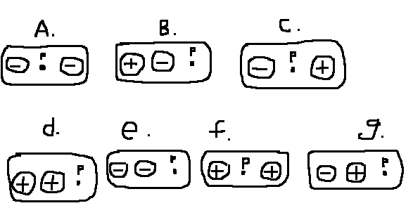

Below are seven arrangements of two electric charges. All of the charges are the same size, 20 C, but they are either positive or negative. Each figure also has a point labeled P that lies on a straight line with the two charges. The distance between any two items is all 5 cm. There are no other charges in this region. A +5 C charge is placed at point P. Rank the strength (magnitude only) of the electric force on the +5 C charge when it is placed at point P from greatest to least.
Fe= k(q1q2)/r^2
help get me started please? :) I don't know how to get started.

What do you mean by that? Is 5 cm the distance from P of both the + and - charges?
ehild
between any two items is 5 cm. For example, in C,
between - and P it is 5 cm and between P and + it is 5 cm.
And what is the distance between + and - in B?
Anyway, the + and - charges are of the same in magnitude, so what about the force they exert on the charge at P if the distances are equal? What about the direction the forces? Draw the forces with arrows in the pictures, and determine the resultant.

Oh! I think I understand it now. Thank you
Hi jeandempsey. Welcome to PF.
Would you like to give your answers & your reasoning so that ehild or one of our other homework helpers can check that you really do understand this.
