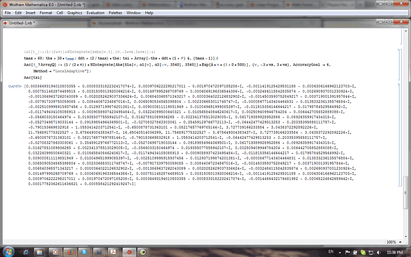

Ok, so its probably because the precision is too big. Now I am confused how to make the calculations with a precision to 0,001 parts of a number. So in case of 0.0019, mathematica would return 0.002?
Ok, It seems I need to use AccuracyGoal for this, however it does not work for me, or am I doing something wrong? I would imagine AccuracyGoal would set the result accuracy to 4 digits, no?
Ok, since no one is replying and it is kinda akward to write one more reply to myself, I am not sure if I have stated the problem clearly. Therefore, I have made a minimum working example ready for compilation. So, as mentioned before I am stuck because the evaluation of NIntegrate takes too long (comments in the MWE). I need to reduce the precision and accuracy of the NIntegrate or rewrite it in some way? Hopefully, I have made it clear this time :) . Thank you in advance.
