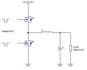

I am trying to develop a circuit to convert 5-18Vdc, 100ma max to 0.4Vdc, 400ma. I am working on a synchronous buck converter design but I am finding limited resources on a discrete design. All of the buck converter IC's I found do not go low enough and have inadequate efficiency when they are even close. I have been toying with the idea of using the basic synchronous converter with a P and N channel fet. The problem is that I am trying to use a MSP430 microcontroller to drive the circuit (this means 3V peak PWM signal). What would you recommend for a gate driver for the upper P-channel fet? If you any other suggestions please put them in too. The load is a thermo electric cooler.
I am attaching a rough schematic for review.
Thanks

Yes, i want to remove the freewheeling diode in favor of a N-Channel MOSFET. The design is then basically just a synhrounous buck converter (as shown in the picture) driven by an mcu generated PWM.
I was hoping that someone had come up with a clever solution to do this without using a driver chip. Most driver chips don't like voltages over 20V, and is also rather expensive. Hence the search for a discrete confiuration.

To a first approximation, you just turn on the flywheel/freewheeling device when the main pass device is off. If you're running in discontinuous mode, you would want to turn off the flywheel device when its current dropped to zero.
You'll probably need to check out some books on DC-DC and switchmode power supply design. Company websites are only going to show solutions using their control ICs, not discrete designs. Out of the three books on my shelf on the subject, only Chryssis ("High-Frequency Switching Power Supplyies -- Theory and Design") discusses synchronous rectification.
