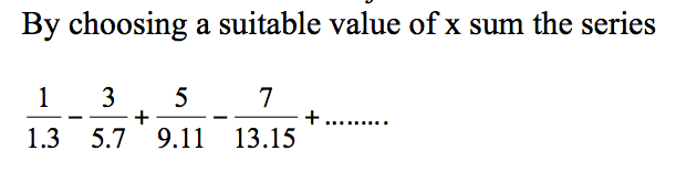

The question:
Here's my thought so far:
This is pretty much what I have come up with. However, I don't know how to find a general solution for the sum of the series. Can someone help please. (the decimal part is where I'm stuck the most)
bubokribuck said:
The question:
[itex]\displaystyle\frac{1}{1\cdot3}-\frac{3}{5\cdot7}+\frac{5}{9\cdot11}-\frac{7}{13\cdot15}+\dots[/itex]
What do we see?
The signs of the terms alternate.
Each successive numerator is the next odd natural number. If n is the index and starts at 0, then each numerator is (2n-1).
How are the two factors in each denominator related to each numerator ? (Consider what 2 times the numerator is for each.)
My guess is that those are not decimal points - they are multiplication dots.
Presumably you have noticed the alternating signs on the terms.
There is a simple relationship between the numerator and the two terms in the denominator in each term which will probably help.

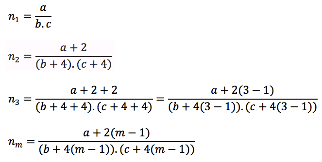

You might also put in the known values for a, b and c (1,1,3) in your formula for [itex]n_{m}[/itex] and simplify.

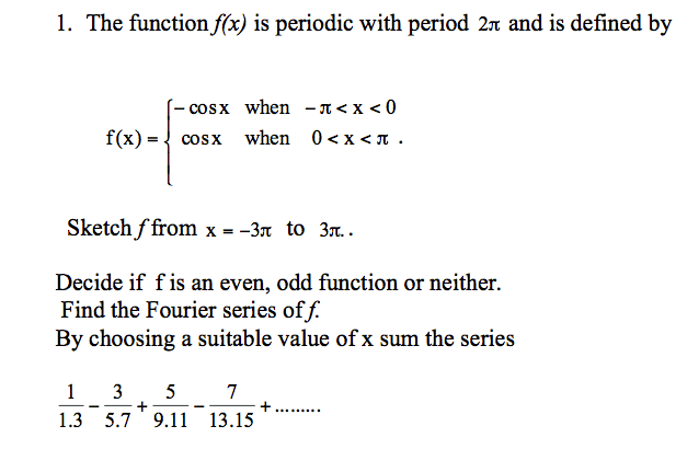

bubokribuck: What is the first part of this problem (that you've cut off from the image you posted)? The statement of the problem ("By choosing a suitable value of x...") indicates that in previous parts of this problem you've found a series representation for some function, which you are supposed to use to solve this part.
spamiam said:
Just a small typo--I'm guess you meant the numerator is 2n+1.
Hi spamiam, here's the full question, but I don't like it has anything to do with the previous parts though.

Hi Joffan, here it is.

Ah, I think I am getting it now!
Let N denotes the numerator, and D denotes the denominator, then D=(2N-1)(2N+1). Is this right? So for the nth term, it would be something like (-1)n+1[itex]\frac{2n-1}{(4n-3)(4n-1)}[/itex]
It definitely has to do with the previous part! What could you be choosing x for if not to plug into the Fourier series you found in an earlier part? So what did you get for the first 2 parts? In particular, what did you get for the Fourier series of the function?

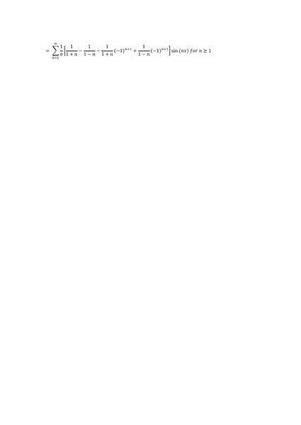

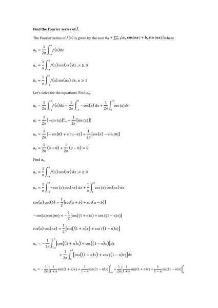

Hi spamiam, here's what I've got for the Fourier series:
And here's the sigma equation I've come up with for the last part of the question.

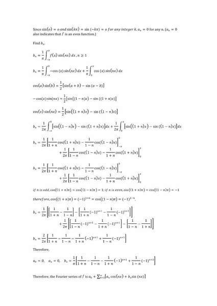

Hm, that's not what I get for the Fourier series. Could you show your calculations? Also, your series has a couple of oddities. For one thing, when n=1, you have terms of the form 1/0. Hopefully this doesn't pose a problem since these terms should cancel out. Which brings me to the second observation--you can simplify your sum since terms cancel out when n is odd.
Hi, the calculations are quite long, so I've attached a document. :)

Hi, the doc exceeds the upload size limit, therefore I can only upload png. Thanks :)
Much better. I think your work is correct. I solved the integral differently, using to applications of integration by parts. As I said before, you really need to simplify your answer. I think you have a correct expression, but you need to combine your terms and put them over a common denominator.
The earlier parts of the problem are supposed to help later on! They can really save you a lot of work. For instance, I knew by inspection that all the [itex]a_n[/itex] were 0 just by observing that f is an odd function. Similarly, you can simplify the calculation of the [itex]b_n[/itex] by noting that the integrand is even.
So try simplifying your answer. Look for cancellation in terms of the form [itex](-1)^k + 1[/itex], too. I think this will make the choice for x a lot easier.

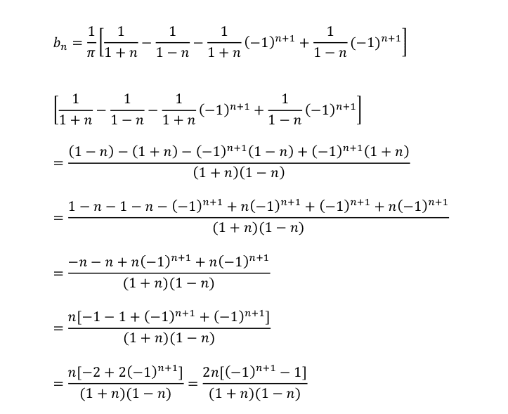

Hi spamiam, I don't seem to be able to cancel out the terms, is there something I've done wrong?
Looks good! The only tiny mistake I see is that you've forgotten the factor of [itex]1/\pi[/itex] during the course of your calculation. One other thing you might want to do is pull out a factor of -1 from [itex](-1)^{n+1} - 1[/itex].
Now write out the series for f again using your simplified version of the bn. This is where the cancellation comes into play. What is the value of bn if n is odd? How does this eliminate terms from the sum?

Hum... I'm not quite sure how to do that, the furthest I can go is:
= [itex](-1)^n(-1)^1 - 1[/itex]
= [itex]-(-1)^n - 1[/itex]
But the problem is when n=1, the denominator is still equal to zero (which is obviously wrong).
It doesn't really matter, but it's just [itex](-1)^{n+1} - 1 = (-1)(-1)^n + (-1)1 = -((-1)^n +1)[/itex]. You can stick that negative in the denominator if you like.
Yes, this is somewhat strange, but I think it's okay, because if n=1, then the numerator is zero, too.
So, as I said before, write out the Fourier series again and look for cancellation when n is odd or even.
