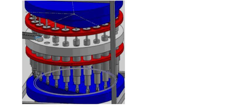

Hi doing a group project on making tea candles! Silly topic but anyway...
my part is to calculate the pressure needed to make a candle and having trouble with the calculations...
final dimension needs to be a 38mm diameter and 16mm height
using rotary compression to do this... candle wax comes in and candle comes out...
here is what i have done yet answer seems extreme, any advice would be great !
oh and have attached a word file with sketch and solid works screen capture so hopefully the whole thing makes some sense!
my workings
assume height of 40mm of wax will drop to give 16mm when compressd
therefore volume of melted wax is
V1=∏r^2 h liquid
=∏(0.019)^2 (0.04)
=0.001134m^2
V2==∏r^2 h compressed
=∏(0.019)^2 (0.016)
=0.00002166m^2
P1V1=P2V2
(101000)(0.001134)=(P2)(0.00002144)
therefore P2=2525kPa
i not really too sure what to think of this value?
not even too sure if i have gone about it in the right way
any help would be great!
oh and can't attach the word file as its too big!

Hi thanks for reply, sorry for mistakes. Think they are corrected below
I was thinking that liquid wax would contain lots of air too but would compressing it significantly not remove the air? Hence just leaving a solid candle?

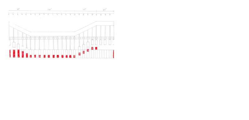

As an engineer I feel compelled to ask what value is added by calculating this
I have attached the general process i hope to use draw in a paint file
Also attached a screen shot of the unfinished process in solid works
Hope its clear
My problem is the candle wax will need to be compressed, yet not too sure how to calculate it
My calculation above is probably totally wrong but a push in the right direction would be great!
pictures should now be attached

From your calculations it appears that you are making an assumption that candle wax is a gas, and for the life of me cannot understand why you would do so. Is the compression prcocess an actual compression, or is it done to ensure that the wax is in the shape of the walls of the container with no air pockets in the finished candle,
