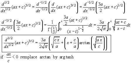

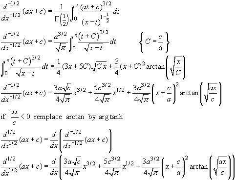

d^1/2(ax+c)^(3/2)/dx^(1/2)=? please help me :)
In using the Riemann-Liouville operator for the definition of the fractionnal derivative, and in order to avoid somme difficulties of integral convergence, it will be simpler to :
First, compute the fractional integral (order 1/2) of the function.
Then, compute the classical derivative.

Even simpler, by performing first the classical derivation, then the fractionnal integration (joint page)
(be carefull with this manner, which is generally not recommended. But in the present case, it works)
