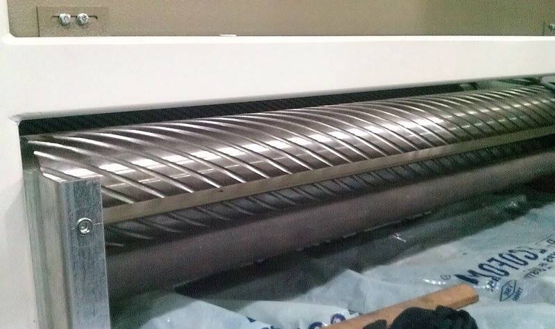

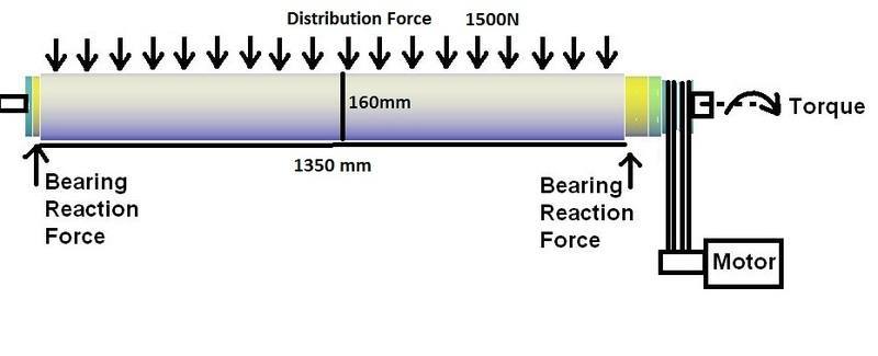

I want to figure out critical speed of hollow shaft. When I calculate from equation, critical speed of this shaft is approximately 10000 RPM. But when I start to increase speed of shaft, at ~2500 RPM I see that the critical speed occurred. What can I do to increase this critical speed to double, (to add mass under hollow shaft?). And what is the problem that I can not calculate real critical values. Assy Configuration, Fixed Shaft, Grooves, Length??

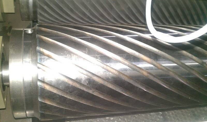

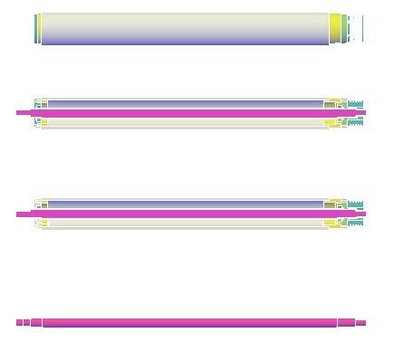

System can be seen at attachment. On the center axis of the shaft, a non turn shaft placed. On this shaft there are two 6308 Ball bearings to allow turn the hollow shaft. On the hollow shaft there are grooves.
Hollow Shaft info:
Material: Steel (I don't know exactly which type, but producer said that ST37/ASTM A283)
Do= 160mm
Di=129mm
Length (Center From Bearing)=1350mm
Total Length=1500mm
Distribution Force (approximate) =1500N

From a hand calc, I get the first vibration mode of the central shaft = about 50 Hz = 3000 RPM.
I guess that is where your resonance at 2500 RPM is coming from.

I assumed the center shaft was a beam pinned at the bearing positions. That is not quite right because presumably it is also supported at the ends and the mass of the outer shaft will have a small effect. That would make the actual frequency lower than my 50 Hz which and that is what you are seeing.
Changing the hollow shaft won't make much difference. You need to change the frequency of the center shaft. If its only purpose is to support the bearings at the ends, you could probably make a different design with no center shaft at all. It's not very clear from your drawings if it has some other purpose as well.

Center shaft doesn't rotate.Center Shaft only for fixing and bearings mounted on it. This was done because I have limited hollow shaft material/tube (Length & Diameter is limited per my design so that I should use inner shaft for unbalance and fix). I can not change design that any new hollow/outer shaft. But I have a chance to make different inner/center shaft if this doesn't take too much time. Or any adding some mass between outer & inner shaft without any unbalance.

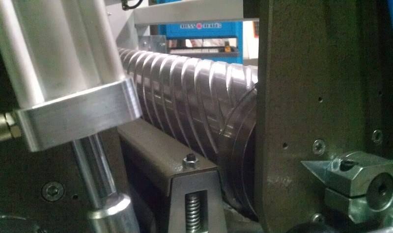

I must not run above its critical speed because of machine/fatigue/bearing life. This is special machine to deburring&grinding hard material. So, I should increase critical speed.

Changing the material of the inner shaft won't make much difference. For the same shape of object, the material property that controls the vibration frequency is the ratio of [itex]E/\rho[/itex], and that is very similar for any structural metal.
You need to make the inner shaft stiffer, and/or lighter. For a beam the frequencies are proportional to [itex]\sqrt{EI/m}[/itex] where m is the mass per unit length. For a circular beam I is proportional to [itex]d^4[/itex] and m is proportional to [itex]d^2[/itex] so the frequency is proportional to the diameter.
You could make the center shaft lighter by fabricating it in three parts, with most of the length as another hollow tube. Or you could machine the solid shaft into a cross-shape to reduce the mass but keep the bending stiffness large.
