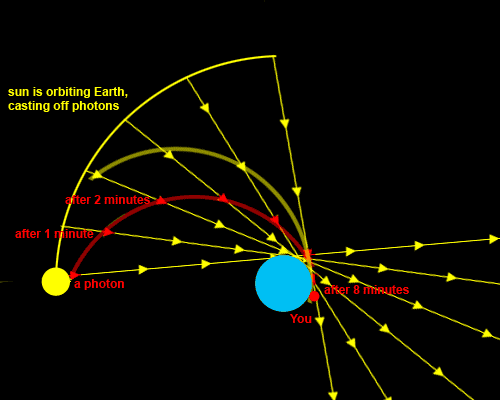

willem is correct (though it took me a while to visualize it). If you look at the frame in which Earth is rotationless and the sun is moving around the Earth, you would observe curving paths of light. A photon would appear to curve over the horizon toward you.
Imagine a photon were instead a tracer bullet, fired from the vicinity of the sun. Someone in the right position could watch it approach. No matter when they looked at it over the 8 minutes (or 8 hours), it would appear as a dot directly in front of the sun (since it's always in line with the sun) - but - the sun is moving across the sky over that time. Your tracer bullet would appear to be following a curved path through space toward them.
If light can reach you from behind the horizon (which means "sunrise" will occur before "dawn"), then it is obvious that this setup is going to mess with your time measurements. You must choose a frame of reference that gives you accurate readings.

The OP asked "will the sun rise 8 minutes earlier". You claimed "It makes no difference". I claim it does make a difference, but not 8 minutes difference (and you haven't attempted to refute my argument).
In what way is that "obfuscation?"
Willem's point that you can see the sun when it is behiind the horizon is exactly the same as my "triangle of velocities" argument. Either you can work in a coordiate system where the path of the photons is curved, or you can work in a system where the path is straight but the horizon moves. Two different ways of looking at the same thing.
