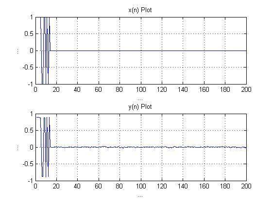

Here is my code:
clear all
n=0:199;
a=0.8814;
D=94;
v=randn(1,200)*.01;
x=[zeros(1,94) 1 1 1 1 1 -1 -1 1 1 -1 1 -1 1 zeros(1,200-(13+D))];
y=a*x+v;
subplot(2,1,1); plot(x); grid
xlabel('...'); ylabel('...');
title('x(n) Plot');
subplot(2,1,2); plot(y); grid
title('y(n) Plot');
The plots from this code

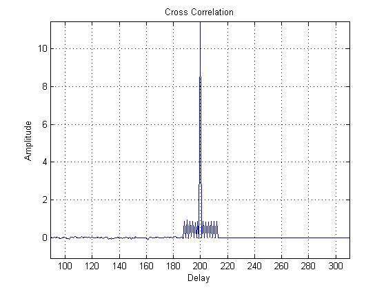

For #4 I reused the code and added the cross correlation:
clear all
n=0:185;
a=0.8814;
D=94;
v=randn(1,200)*.01;
y=a*x+v;
z=xcorr(x,y);
subplot(1,1,1); plot(z); grid
xlabel('Delay'); ylabel('Amplitude');
title('Cross Correlation');

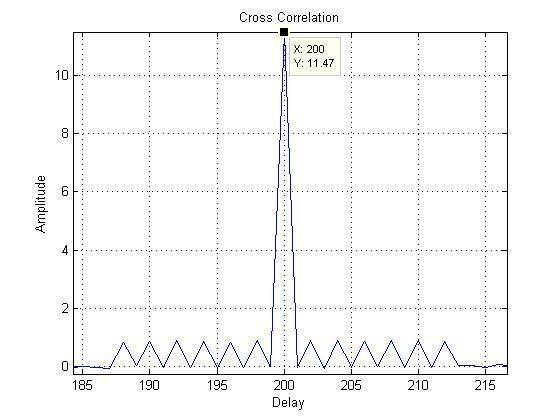

The plot of my calculated cross correlation
From looking at this plot of the cross correlation I would say the delay is at 200. The delay I used in the data was 94 though? Where am I going wrong?
Thanks for any help on this and sorry for the super long post.

Ive looked over the code again and I have a feeling I am on the right track. Maybe I am just not understanding how the cross correlation in MATLAB works?
Im using the function xcorr
does anyone have experience using this function?
Hey Evo8! :smile:
If you look at you graphs of x and y, you can see that there is no delay.
The vector y only has a little noise.
You should define x without the delay zeroes in front, and y with the delay zeroes.
Now, your cross correlation gives you a peak at 200.
Since your vector is 200 entries long, this corresponds to a delay of 0, which is what you have now (it wraps around).

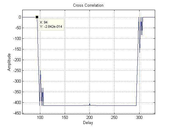

However I am looking at it again now and I think I see a problem with my y definition. In the problem statement it is defined as follows y(n) = ax(n − D) + v(n). I didnt seem to include that -D in my y definition.
I changed my code to the following: (See changes in bold)
clear all
n=0:185;
a=0.8814;
D=94;
v=randn(1,200)*(.01)^2;
y=a*(x-D)+v;
z=xcorr(x,y);
See the associated plot here:
No you can see that I've placed a data cursor where the plot drops out. This happens to be right at 94 which is my delay. Does this look a little better? Why does it go back up at 300? I also see a very small spike at 200. This is where my array ends I assume?
For reference here are the input vs. output signals
I feel like I am getting close but the data my not be as clean as it should be?
Thanks for your response

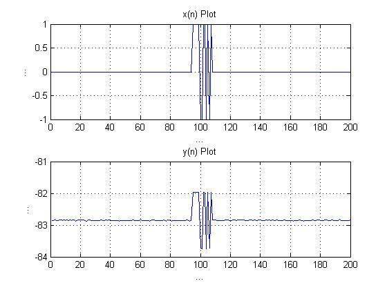

y=a*(x-D)+v;
I think your y is not quite right yet.
You have subtracted D from the amplitude of x (vertically) and not from the index of x (horizontally), which you can see in your graphs or x and y.
Perhaps you could try something like:
undelayed_x=[1 1 1 1 1 -1 -1 1 1 -1 1 -1 1 zeros(1,200-(13))];
y=a*undelayed_x+v;
hmmm I am not sure this is quite right either though. First the delay D is not used at all in either x or y. So how could I see a delay of D if its not used? This is what I get for plots if I use this code:
clear all
n=0:185;
a=0.8814;
D=94;
v=randn(1,200)*.01;
y=a*x+v;
z=xcorr(x,y);
Also I am quite confident that my X is correct. My y however I believe is my issue.
See this text taken from the problem statement
Choose D to be the last two digits of your birth year + the day of your birth. If your birthday was August 21, 1989, D = 89 + 21 = 110. Thus, in y(n), there will be D zeros prior to the beginning of the Barker sequence and enough zeros afterwards to increase the length of y(n) to 200.
This one is stumping me. I am not sure how to go about it. The closes I've come is the previous set of plots. But as you said I am affecting the amplitude not the correct delay?
As you can see in the graph, y is still not shifted in time.

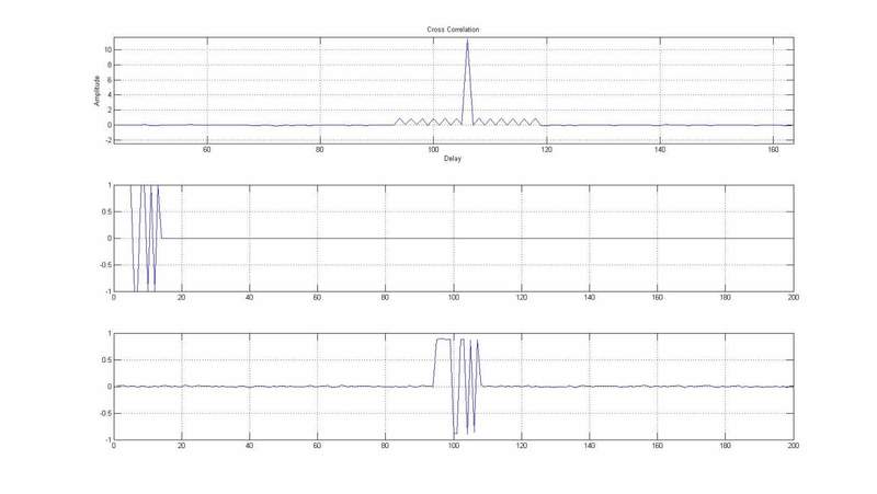

Ok now i think i may see where you were going with this. I was a bit confused.
So this is what i have for code: Note this is only the parts of interest right now.
delayed_x=[zeros(1,D) 1 1 1 1 1 -1 -1 1 1 -1 1 -1 1 zeros(1,200-(13+D))];
y=a*delayed_x+v;
z=xcorr(x,y);
The plots below are ordered as follows. Cross correlation on y and x. x and then delayed_x. Where i think i didnt really understand was that the y is using the delayed x, when computing the cross correlation I am using the non delayed x and the y which has the delayed x within. Now I get a time shift.
The cross correlation shows a peak at 106. This is somewhat close to my delay of 94? How does this look now? where does this discrepancy come from? The nature of computing cross correlation?
Thanks for the help ILS
Good! :)
The discrepancy is because the shift is counted as negative (it is y[t-D]).
Since your vector has length 200, it wraps around and 200-94=106.
Ah this makes sense!
Thanks so much. I apologize for not understanding where you were going with this. The gears were turning but it took a little bit for them to get up to speed.
Thanks again!
