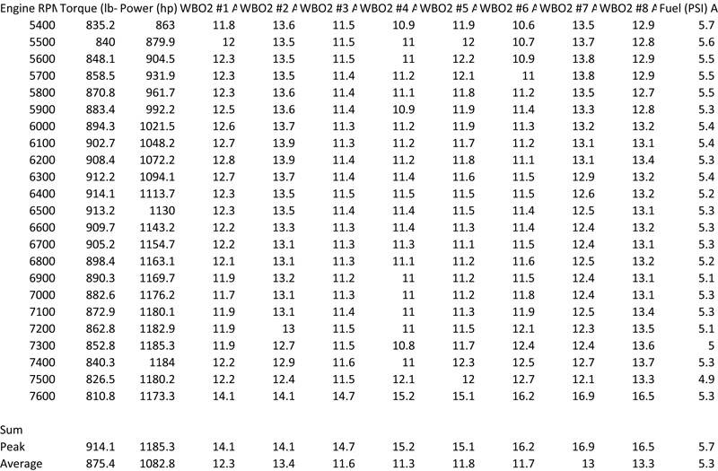

Below shows a carbed engine, I think its a SBC (from here http://speedtalk.com/forum/viewtopic.php?f=15&t=29451&start=45)
If you're just using one O2 sensor on each bank there's going to be some discrepancy, and O2 sensor readings are affected by temperature, pressure and calibration as well.

The chart you posted (that's a 622 big block by the way) has an average of 12.17 A/F on one bank and 12.47 on the other. The big issue however is the presence of cylinders running in the high 13's; to keep the engine in one piece they're having to overfuel the other cylinders. Getting the lean cylinders down into the low 13's would allow the other cylinders to get out of the high 11's and make more power in the high 12's to low 13's (I'm assuming a few things based on my years of race engine building).
Note that I didn't say the engine would make peak power at stoichiometric, just that as the conditions in the engine become more consistent a clearer picture of what the engine really wants for mixture will appear. In other words, recent development is revealing the 12.5:1 "standard" was needed to "crutch" the engine to keep it alive at full throttle and a higher A/F ratio makes more power when the crutch isn't needed.

I think so, but we can only go by the average until we have more detail. Still, as I said the indication is that with better fuel distribution and A/F ratio control there is less need to compromise the other cylinders to keep some cylinders out of trouble, the power peak will be trending toward stoichiometric. How close remains to be seen but some reputable builders are using 14.0:1 as their target. I suspect that the trend for peak power at leaner mixtures reflects better mixture control inside the combustion chamber as well as between cylinders.
