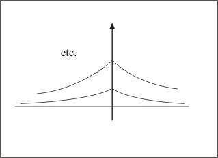

gogza
Folks,
Imagine a chain, floating in a frictionless, weightless environment.
Just like this:
where every "-" is link.
If a force acts on just one link of the chain "Link0", causing it to buckle like this (and the force continues to act) :
-------------\_/---
(apoligies for the crudeness of my diagram)
What forces will act on the links either side of Link0, causing them to move? Do the first nearest neighbours (to Link0) have the same magnitude of force?
If they don't, is it because the mass on either side is different?
Help! Its been a few years since I last forayed into classical mechanics!
Thanks,
Gogza

Some Clarification
Thanks rayjohn01/Lore Booda for your replies, :smile:
Having looked into "cantenary" problem, I don't think it covers what I'm looking for.
Perhaps I've not explained myself properly. I'll have another go.
OK we've got our frictionless chain again and this time its lying out straight on a frictionless table, both ends are free.
If I take my finger, place it on just one link and push this link forward the rest of the links will follow.
The force applied by my finger will be used to:
a) accelerate the link I'm touching.
b) accelerate the links to the left of this link.
c) accelerate the links to the right of this link.
If I push the middle link forward, I'll get a symmetrical curve. The force applied, after a), will be split equally for b) and c).
However, what happens if I push a link closer towards the left end of the chain? I'm thinking its one of these answers, of course the correct answer would be best!
1) the forces for b) and c) are not equal because the mass on either side is different. The curve remain symmetrical.
or
2) the forces for b) and c) are equal(?) but the curve is not longer symmetrical.
I guess what I'm looking for really, is equations that give the forces acting on each link, depending on its distance from the point of applied force (if possible!)
Thanks for your help so far,
Gogza

To Gogza
The chain curves in general will not be symmetrical due to the difference in inertial mass on either side of the chosen link ( there is NO friction ) , curves will be straight lines
(IF the force is very light wrt the masses ) their angles will be such that the vectors
sum to zero if you consider the total link mass on either side of the link.
However there is a nasty trick here ( due to your removal of friction ) any applied force will cause the links to accelerate and then NOT to stop .
Second since the chain is clearly not stiff -- if you consider a small motion of the chosen link it will be normal to the chain , the tension it causes is directed down the chain on either side according to mass distribution , as regards the last links they see a force ~ parallel to the chain their mass resists this but they travel INWARDS
The amount of resistance is dependent on how many links you consider , that is the tension is different down the chain therefore the inwards accelleration is also different -- That is I believe the chain forms two different cusp like shapes which continually change if the force is maintained until they form straight lines behind the leading link .
I suggest this is a very nasty exercise in calculus which is DYNAMIC until the force is removed. Even then the implied shapes will mean complex analyisis as there are two not one -- unless you choose the central link.
It 'might' be simpler to simulate this.
Unlike 'Ivy' I AM assuming mass (not weight) -- if there's no mass then any force creates infinite velocity of a straight chain. And Mr Ivy can direct his answers to the questioner.
Ray

Thanks rayjohn01,
Exactly what I want to do! (Oops, perhaps I should have mentioned that, sorry!)
The question is how do I simulate this?
I'm trying to work out how a single link will move after considering the external force applied to it (this only affects one link) and the internal forces applied by the other links in the chain.
For each link, I can model the external forces applied to the chain (straightforward, enough). But I've a huge problem modelling the internal forces in the chain.
If I consider an end link then the only force causing this to move (inward, as mentioned), it exterted by its neighbour. But what is this force? I think its as simple as summing up all the forces acting on the other links. BUT (and as you can see it its a big but) I don't know how inertia of the links affect these forces.
I guess my problem lies with inertia of the other links and how this affects the internal forces.
