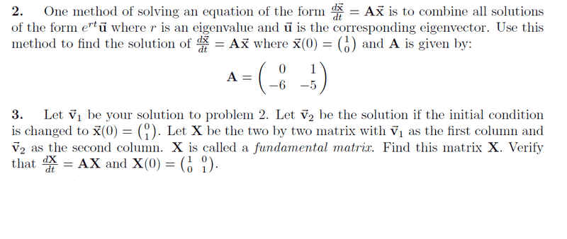

The questions are in the image

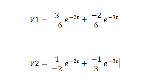

My solutions are
V1=3*(1 -2)e-2t+ (-2) (1 -3)e-3t
V2=1*(1 -2)e-2t+ (-1) (1 -3)e-3t
How do I get the X matrix since my solutions are in exponential still.

According to your solution,
[tex]X=(v_1\ v_2)=\begin{pmatrix}3e^{-2t}-2e^{-3t}&-6e^{-2t}+6e^{-3t}\\<br /> e^{-2t}-e^{-3t}&-2e^{-2t}+3e^{-3t}\end{pmatrix}.[/tex]

You can write v1 as a single vector:
$$\vec{v}_1 = \begin{pmatrix} 3e^{-2t} - 2e^{-3t} \\ -6e^{-2t} + 6e^{-3t}\end{pmatrix}$$Do the same for ##\vec{v}_2##.

i get that part but after that what do I do to get just numbers in my 2x2 matrix so that I can prove dx/dt =AX and x(0)= \begin{pmatrix}1 0\\ 0 1\end{pmatrix}
Like the problem says, the first column of X is v1. Its second column is v2. It's not going to be just numbers. I'm not sure why you think it has to be.

Okay but then if I put t=0 into the x equation, I do not get the identity matrix and how would I verify that dx/dt=AX by just differentiating the X matrix?.
Thank you for all the help
Show us how you're calculating X when t=0.
Okay I got just did a arithmetic error, but how do I verify that dx/dt=AX
Calculate both sides and show they're equal to each other.
