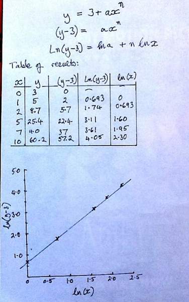

Are you OK with the step
Y = 3 + ax^n ? You cannot take Ln(3 + ax^n) so I rearranged the expression to be
Y-3 = ax^n and this is the power law equatio that can be analyzed
Now take logs...Ln(y-3) = Ln(a) + nLn(x)
This equation is in the form of a straight line graph ( y = mx + C)
So plot Ln( y-3) against Ln(x) and you should get a straight line.
The slope of the line is n and where the line cuts the Ln( y-3) axis is Ln(a)
You need to make another table to get the values ( y-3), Ln(y-3) and Ln(x)
Hope this helps!
I tried it for x =7, y=40.
Ln (40-3) = ln (a) + n ln (7)
3,6109 = ln (a) + n * 1,94
The problem now is that I have two variables? I don't know how to figure them out. You told me to plot the result but It's difficult with two variables. Mabye I am just stupid?

here you go, not brilliant copy but I hope you can see what I did

Thank you. That's similar to what I did the first time I tried but I guess I got a bit confused :) I managed to get a function that is very precise now :D Thank you for your valuable help! It feels great when you finally understand :D
