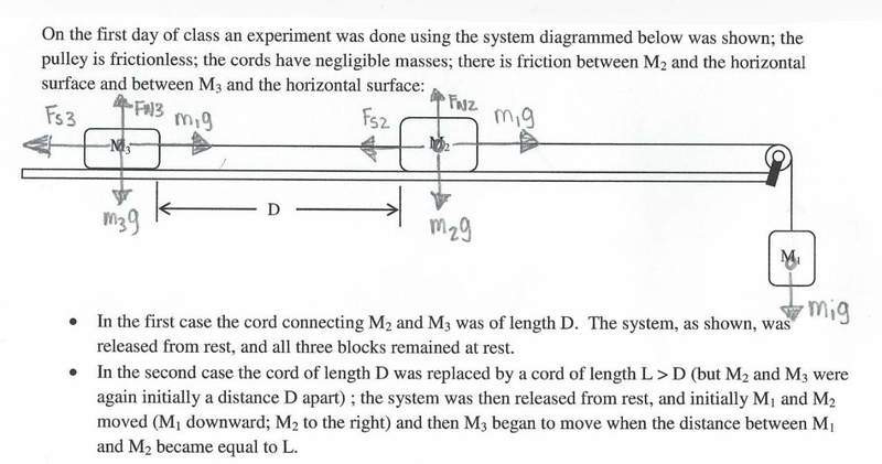

We are trying to predict the speed of all three blocks at the first instant they all have the same speed using only variables.
