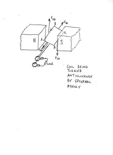

Lastly, when I turn the handler of the coil in the ac generator, eg with 10N. Will the force solely act at one side of three armature or will the force be divided into 2 then they will act at the 2 ends and one is upwards the other downwards?

You're asking about an a.c. generator, I assume. Are you taking it to be a simple rectangular coil being turned in a uniform field? In that case, for most orientations of the coil, both pairs of opposite sides will experience equal and opposite BIL sinθ forces on their two sides. For one pair, BC and DA, the forces will simply cancel. For the other pair, AB and CD, the forces, FAB and FCD, although equal and opposite, don't act in the same straight line, and will constitute a 'couple' giving rise to the clockwise torque that opposes your turning of the axle.

Oh ok I get it. But also, won't there be opposing forces due to the new induced current and also the magnetic field? So by Fleming's left hand rule, there's an opposing force. So how so do they turnl
Thanks for the help.
The current I've shown in the diagram, and which gives rise to the forces I've been talking about, IS the induced current! Remember, this is a generator: you (or some external agency) has to turn the coil – using a torque which has to be at least as large as the opposing torque due to the BIL sinθ forces due to the induced current.
[If the generator is 'open circuit' coil not connected to any load, but terminals not connected to anything, an emf will still be induced as you turn the coil, but there will be no current, nor any opposing forces.]
