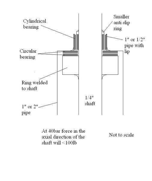

Hello, I am trying to find a bearing that will allow a shaft to pass into a loop with 50bar of pressure. The basic schematic is the idea since this thread:
The water jacket protects the bearing from high temperature as the oven will heat up the fluid to a maximum of 450dC. I assume I will be looking for a plain bearing rather than a rolling element bearing. Is there any of the shelf bearings that would fit the bill?

Thanks for your response, I was beginning to think this project is impossible. I've been in contact with a company called graphalloy which makes graphite bushings which can deal with high temperature. No water jacket would be required with a graphite bearing which could allow the shaft to be much shorter. The motor needs to be thermally isolated from the loop; it is likely that it will be connected to the shaft via a belt or chain, unlike the first diagram. In this case the motor will not support the shaft.
This is a more detailed idea for the shaft mount/bearing, my background is more physics than mechanical engineering though so I am not an expert in designing such things although it is an interesting thing to do. Any more advice welcome.
The Graphalloy seems like a good choice. In general, your arrangement looks fine. I think the preference would be to put the bearings outside of the sealed area. At that point, you could even use rolling element bearings. If you drive the apparatus with a belt, you'll be putting a side load on the shaft which must be resisted by the bearings. Also, the seal you use will be affected by your bearing set up. The bushings that you show will alow some slop in the shaft, but seals don't like shafts that move around. Best to consider your seal and bearing as a combination.

I might be making a mistake here but I was imagining that the bushings would act as plain bearing and seal the loop at the same time. In the diagram I have shown exaggerated gaps between the bushings, I was think that the pressure would hold the circular bushings tight and sealed. As I say this is not my area of expertise.

Hi Jack_O. Thanks for responding to the questions. It helps to put your design into perspective. I see you're not worried about solidifying anything, the pressure and temperature are to maintain your fluid as a liquid, so we don't have to worry about heating the bearing or seal area. Those areas can be relatively cool so the fluid will be subcooled liquid in that area. If that's the case, I think you want to run your bearings and seal at ambient temperature by providing a thermal stand off between the hot process liquid and seals/bearing area. All you need to do to provide this thermal isolation is to extend your shaft away from the hot portion enough to allow for a thermal gradient between the two. Heat is rejected all along this thermal stand off either by using fins to reject heat directly to atmosphere, using water as you show in one diagram, or some other method. The clearance between the shaft and housing in this case needs to be as small as possible to prevent the liquid from setting up convective currents between the cold end and hot end. In the picture below, you can see a typical high temperature pump that has the motor, seals and bearings at one end and the hot impeller a distance away on the long thermal stand off. I would think your Graphalloy bushings would be ok in the hot end but regular bearings and seals would be added to the cold end of the pump housing.
Regarding the use of bushings as seals, that might work but the problem will be in maintaining the two rotating faces perfectly parallel to each other. If one side lifts up or even if it just has a reduction in contact pressure, the seal could leak. The way it's normally done is to provide a pressure energized seal mounted on a bellows or similar device that allows the seal to follow the face it is sealing against such as in the picture below.
http://www.conlyn.com/brands/pss/pss_components_diagram.gif
This image is for a seal on a boat shaft so it's very low pressure. The bellows especially isn't capable of handling any significant pressure. Better seals use metal bellows in this location, generally a type called "edge welded" to allow for the axial motion and to keep the seal against the hardened metal face. Spring load and pressure behind the seal help force the two parts together and create a seal. In your case, the flat washers you have might be able to accomplish this to some degree but they will need some preload, preferably by a spring pushing on the axis of the shaft, and they have to be absolutely flat and the shaft can't wobble at all or you'll have one edge lift up and it will leak.
