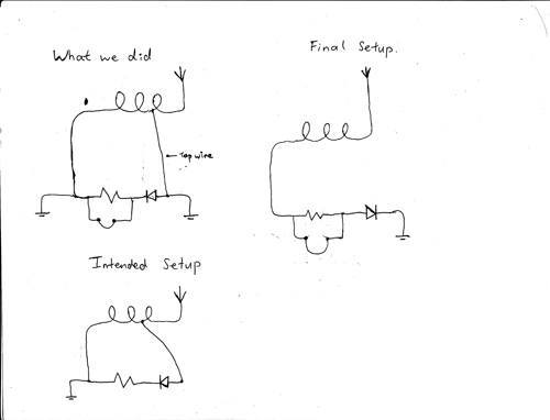

Yesterday I got the parts, put the radio together and success! I could actually hear a few
radio stations. The sound was barely audible, and everyone had to be quiet if we wanted to hear anything. I'm not sure if that's the norm with crystal radios though.
Details of setup:
-15m of 24 gauge magnet wire tethered by insulating string 1.5 m above the ground
-4m of regular wire connected from set to an outdoor water pipe
-24 gauge magnet wire wrapped around an 8.5cm diameter thin plastic container,
with sanded taps at every 5 turns
-47kohm resistor in parallel circuit with earphone, as suggested by sciencebuddies.com
-germanium diode
Specifications of diode
Peak Inv. Voltage(PIV): 60 Volts
Max. Average Rectified Current: 50mA @ 25 deg C
Junction Temperature (TJ): 100 deg C Max.
FWD Voltage Drop(VF): 1.0V @ 5.0 mA
Reverse Current: IR 15uA @ VR 10 volts
Strange things that happened during experimentation:
When the wire coming from the tap was connected to the junction (as planned in the diagram) , we heard a lot of interference. We removed the tap wire, and for some reason we got a clear signal without interference, so we reasoned that the signal must have passed through the coil, into the junction that was supposed to go to the ground (whoops), through the earphone diode setup, and finally was grounded through our fingers which held the alligator clip at the other end.
(we must have installed the diode backwards :rolleyes: but it appears that the direction of current through the earphones doesn't make a difference)
This setup is drawn in my attached diagram.
So then we went with how things were, and moved the ground wire to the other side so that we didn't have to use our fingers to ground it. This setup is also drawn in my attached diagram. (The intended setup by sciencebuddies.com is drawn too.)
After the final setup we removed the coil altogether to see if the coil does anything.
And we still had the signal :rolleyes:.
My questions:
What is the coil's purpose?
Why did my taps produce static?
Why did sciencebuddies recommend wrapping around a 10cm container and making a tap
every five turns? Did they use an equation to calculate that?
Thanks to everyone who patiently read through my post.
You are using the word "tap" in two different contexts, and getting me confused. Can you refer to one as "the water pipe"? :-p
The purpose of the coil is twofold: it makes the audio much louder, and also allows you to tune between different stations. If you couldn't turn between stations, then listeners in a big city would hear all their local stations chattering away together!
If you can hear a station without the coil, then you are probably located very close to that station's transmitter.
Yes, using body capacitance as 'ground' is a common technique, but a water pipe or some other object is usually better. (People in apartments where the water pipes are plastic may have no recourse to an earthed metal water pipe.)
The diode can be connected any way 'round here. A lot of "static-sounding" interference is probably due to a poor connection, but there could be other electricity going through the water pipe to ground, and that will affect your crystal radio.
Why did sciencebuddies recommend wrapping around a 10cm container and making a tap every five turns? Did they use an equation to calculate that?
Theirs is an unusual design, because they omit the usual tuning capacitor. I'm surprised that it works, if in fact it does. They must have found that it is good enough by testing it.
