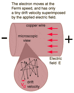

why electric current flows at speed of light when we know that current is due to the drift velocity of electron which is only few km/s(i think)?
hi asad1111! :smile:
no, the electric field travels (away from the electrons) at the speed of light
the electrons themselves get left behind! :biggrin:
asad1111 said:
... we know that current is due to the drift velocity of electron which is only few km/s(i think)?
The drift velocity of electrons in copper wire is
http://hyperphysics.phy-astr.gsu.edu/hbase/electric/ohmmic.html
