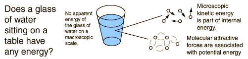

I think what you mean here regards the microscopic energy. From Hyperphysics:
Internal energy is defined as the energy associated with the random, disordered motion of molecules. It is separated in scale from the macroscopic ordered energy associated with moving objects; it refers to the invisible microscopic energy on the atomic and molecular scale. For example, a room temperature glass of water sitting on a table has no apparent energy, either potential or kinetic . But on the microscopic scale it is a seething mass of high speed molecules traveling at hundreds of meters per second. If the water were tossed across the room, this microscopic energy would not necessarily be changed when we superimpose an ordered large scale motion on the water as a whole.
MICROSCOPIC ENERGY
Internal energy involves energy on the microscopic scale. For an ideal monoatomic gas, this is just the translational kinetic energy of the linear motion of the "hard sphere" type atoms , and the behavior of the system is well described by kinetic theory. However, for polyatomic gases there is rotational and vibrational kinetic energy as well. Then in liquids and solids there is potential energy associated with the intermolecular attractive forces. A simplified visualization of the contributions to internal energy can be helpful in understanding phase transitions and other phenomena which involve internal energy.
Ref: http://hyperphysics.phy-astr.gsu.edu/hbase/thermo/inteng.html
Correct, but the notation for internal energy :U appears also in the expression for the first law of thermodynamics.
So to speak: adding heat and adding work increases the internal energy U, but for the eqaution of enthalpy h=u+p.v , only u changes...? I do understand the physical meaning of enthalpy now.
Like u states with the example of the glas of water, to give rise to it's volume, work has to be done to force the volume expanding against atmospheric pressure. Ok, but in therms of enthalpy, U changes because of the first law of thermodyanmics but also p.V changes because de rise of volume...
The 2 formulas: first law of thermodynamics and enthalpy get me rather confused here.
