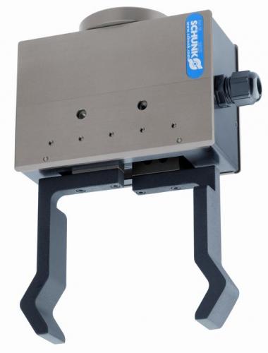

P: 6,187
How about a sliding gripper?
Something like this:
Femme_physics
#17
Mar16-12, 05:06 PM
PF Gold
Femme_physics's Avatar
P: 2,551
Well, that's essentially what we've made so far in the last solidworks animation (imagine that at the end there are 2 jaw grippers like in your pic. The difference between my idea and your pic is:
A) Mine drives the end-effectors directly. Suppose I could mount on the rails grippers like yours.
B) Yours doesn't show internal design
