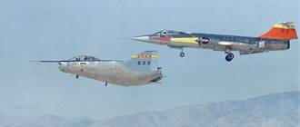

A sharp edge can reduce drag, but depending on the factors, wing loading, wing size, air foil, speed, angle of attack, ... , it's common to have some upwash at the trailing edge of a wing because the pressure is still lower above and higher below as the two streams rejoin. A blunt trailing edge will result in more drag, but such an airfoil can still work, as seen in this old photo of a pre-shuttle lifting body prototype (M2-F2), in this case a glider version (there was also a rocket powered version called M2-F3):
Looks like a flying bar of soap! It must be very interesting to scan the parameter space in search of the ideal solution for given flight characteristics. I recall hearing that a "flying wing" design was once found to be an extremum in fuel efficiency, but it was later determined to be a minimum not a maximum! I don't know if that's true, it's often cited as motivation for understanding what a second derivative is.

Since it was a pre-shuttle prototype, the M2-F2 was designed to handle re-enry from orbit from space. The last version of the series, M2-F3, was able to achieve mach 1.6, so either a lot of rocket power, or it's not as draggy as it looks. The front top portion is flat, while the front bottom portion is shaped like 1/2 of an expanding cone. The tail end of the M2-F2 is tapered, with the taper starting sooner on the top and the trailing blunt edge is somewhat below the nose. There's a flap than can be deployed off the bottom of the tail end, my guess it that is for slower glide speed. I like the M2 series because the hump is on the bottom, dispelling common mis-conceptions about how wings generate lift. Also I think it looks cool and unusual.
