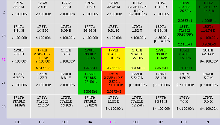

Hf has 5 stable isotopes (Hf-176, 177, 178, 179, 180) and one quasi-stable isotope, i.e., an isotope with a long half-life, Hf-174.
Hf-174 has a thermal σ(n,γ) cross-section of 561.7 b, where σ(n,γ) = thermal neutron capture cross section at 300 K, in barns.
Hf-176 13.76 b
Hf-177 373.6 b
Hf-178 84.05 b
Hf-179 43.59 b
Hf-180 13.01 b
http://www.nndc.bnl.gov/chart/reCenter.jsp?z=72&n=106 select σ(n,γ) and Zoom 1. http://www.nndc.bnl.gov/chart/reCenter.jsp?z=64&n=91
A subsequent daughter from transmutation, Ta-182, has a cross-section of 8289 b.

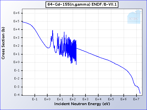

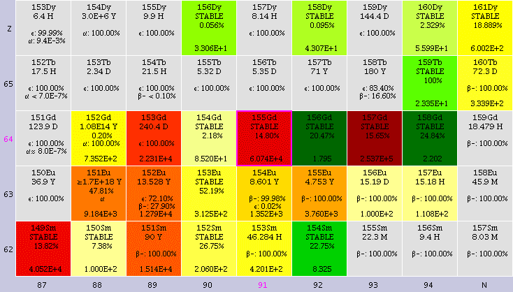

Gd by comparison has a much higher cross-section for thermal neutrons
Gd-155 60740 b
Gd-157 253700 b
However, one must look at the isotopic vector for natural Gd.

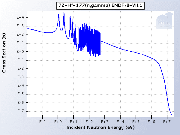

One can also find more data here for different cross-sections.
http://www.nndc.bnl.gov/sigma/index.jsp
Click on an element then select which isotope/nuclide, then which cross-section. Gd-155 has a benefit below 1 eV. One could do an annulus of Gd sandwiched between an inner and outer tube of Hf. The center could be hollow for a flux trap. Any fast or epi-thermal neutron slowing down in the water filled interior would be readily absorbed in the Gd, or Hf.
