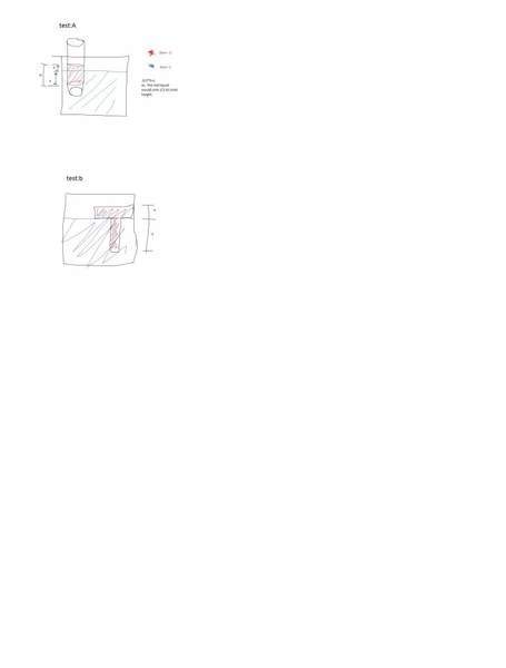

take a glass of water and place a straw in it. Now put oil in the staw.
the amount of oil above the water is given by the equation.
ex)
density of oil=d1(.5)
density of water d2(1)
height of oil column = H(10")
d1/d2 x H = amount of oil under water line(x) x=5"
H-x= amount above(p)p=5"
now say (p) is one fluid ounce " it is in a vertical column". if you changed the shape of the column above the water line would (p) still have to be the same height to push the oil to a depth of (x)? Or is it the mass of the water above to the water below what counts.
I have tried this with wood and the shape of the above part dosent mater. the bottom part always sinks to the same depth.as long as the ratio top/bottom is the same. is this true for liquids?

more info: what I want to know is if I change the shape of the conainer of the one ounce above the water line so the original height of 5" is now say two inches but still holds one ounce will the oil still sink to 5"?
Its my understanding the above equation only works for a column.
If you put in two straws, side by side, one with water and one with oil, the pressure at the bottom of the two straws is equal. At the top of the liquid column in each straw (meniscus), the pressure is atmospheric pressure. Calculate the pressure in each straw as a function of the distance below the two meniscii, and show that it is equal at the bottom of both straws.
