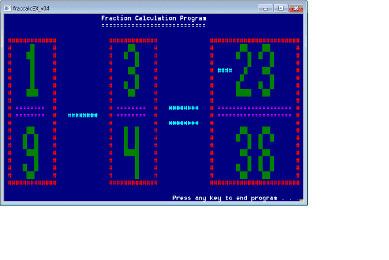

This program has been assigned in my intro to programming course, which assumes no previous knowledge of programming. Up to this point we've only been required to write functions that accomplish specific tasks within a program. This is the first time we've been asked to design and write a full program.
These are the requirements for the program:
a) it will handle any single-digit addition, subtraction, multiplication, and division.
b) as a result of the math, there is a potential for up to three digit results, so the program must handle this
c) as a result of the subtraction process, it is possible to arrive at a negative answer; the program must handle this
d) the program must also manage incorrect input for all four input values and the operator. This means that if any non-digit value is entered as a numerator or denominator, if a zero is entered as a denominator, or if any character other than '+', '-', '*', or '/' is entered as an operator, the user must be informed and the program must be stopped immediately without any further processing
Here are a couple screenshots showing what the TUI looks like after the calculation has been made:
My issue:
I need to do some analysis to determine precisely when the answer will be negative and when the numerator will have two or three digits. I also need to know when the denominator will have two digits. The function used to print the green digits can only print one digit at a time, so I also need to find a way to separate my digits for the answer and print them individually at the correct location on the screen.
I started writing out all the possible fraction values a user could input and discovered that a brute force method here is unreasonable, as I would have to check a few thousand different combinations to get what I'm looking for. I need a more elegant mathematical approach that will lend to a readable and efficient function.
I've reasoned that the denominator can never be larger than 81, since only single digit values are allowed as input, so I do not need to test for a three-digit denominator. However, it is possible to have up to three digits in the numerator, so I will need to test for this and adjust my output to the screen accordingly.
Hi Dembadon! :smile:
You might convert your number to a string and get its length.
Hi ILS! :smile:
Your suggestion is very clever. Thank you!
So you are doing
a/b - c/d
So the program probably has variables for a b c and d. To see if it is negative just say
bool isNegative = a/b - c/d < 0
Thank you both for the help! The program runs flawlessly. =]

Well, I noticed a flaw in my program when doing some last minute testing to see if I could break it.
Since we are required to halt all processing if invalid input is detected, I decided to see what would happen if I just hit enter at one of the integer prompts without giving it an integer. I discovered that a zero is sent! This is problematic; we were given a fully-functional .exe so that we can see how the program is supposed to function. The example program does not do anything when the user presses <enter> without providing values, it just sits there. Oddly enough, this is the way my program behaves when prompting for the operator (which is a character), but it will always send a "zero" when I hit <enter> at the integer prompts.
Where is the zero coming from?
Which function(s) do you use to read input?

What is the function getInputString() supposed to do if you press Enter?
I'm guessing that if you press Enter, the function getInputString() returns an empty response.
Your function promptForIntAt() returns a zero in that case.
Would this be the NULL_CHARACTER constant I see defined in the function? If so, it has been assigned \0, so I'm still not sure why it is returning the integer zero.
We don't start "while," "for," and "do" concepts until tomorrow when we begin file I/O, so I'm having difficulty following everything in his functions.
No, it's not the NULL_CHARACTER constant.
The function getInputString() returns an empty string ("") when you press Enter.
As a result the function promptForIntAt() returns the number 0 when you press Enter.
This means that with the functions of your professor you cannot distinguish between the number 0 and Enter being pressed.
To prevent your program from responding to Enter with a zero, the only option you have now, is to check for the number zero and handle that as an invalid input.
