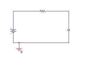

We know charge is accumulated on the conductor plates of capacitor. Here is a circuit (image) with voltage source, resistor and capacitor. Now due to the capacitor the circuit is actually open so flow of charge aka current is zero. Then how can charge be accumulated on the plates of capacitor?
It is only open at steady state, meaning after the circuit is in this configuration for a long time so that only the DC component of your voltage source is present.
Before the circuit is in the state of your schematic, there is no charge accumulated on the plates and so there is no voltage across the capacitor, this is known as an initial condition. Once the voltage is applied, charge flows through the resistor and begins accumulating on the plate. Initially, since there is no charge on the plate and so no voltage, all of the voltage is dropped across the resistor. As the plates begin filling up with charge, their voltage increases and so less voltage is across the resistor and so less current is flowing. Once enough charge has been accumulated on the plates so that its voltage is equal to the voltage of the source, the voltage across the resistor will be 0, and so no more current will flow. This is when it is considered an open, and in stead state -- the charge is already accumulated.
So, you should know that the capacitor is only an open to DC voltage/current, and not to AC.
Though voltage is applied the circuit is in open condition so the current flowing through resistor should be zero isn't it?
samieee said:
Thanks for your reply.
The circuit is only in the open condition once enough charge has accumulated on a capacitor so that its voltage is equal to the DC voltage applied.
Remember the voltage on a capacitor is V = Q/C, so as more charge is added, its voltage increases.
To your question specifically, if the capacitor is already in the charged condition, then the current flow through the resistor will be 0.

Eventually, yes, with DC applied.
But before that? Isnt it open in all conditions due to the dielectric between the plates?
No. If there was initially no charge on the capacitor, and then you put it in a circuit with current, the current coming into it would get "captured" by the capacitor, and the charge of the current will start to accumulate on the capacitor. This actually means that the capacitor is acting more like a short circuit rather than an open circuit in the very beginning. Once the capacitor has captured enough charge, its voltage increases til it cannot capture any more charge, and this happens over a long time. When it is finally filled with charge that it can't take anymore, it acts like an open circuit.
The dielectric simply determines how much charge the capacitor can hold at a given voltage. It determines what the capacitance value of the capacitor is, and so you can see from what I said before V = Q/C, if you rearrange it to how much charge it can hold per a given voltage C = Q/V. Its basically telling you how much energy the capacitor can store inside its dielectric.

I think you are using the word 'open' wrongly which is leading you to a false conclusion. Any 'open' circuit - even the gap between switch contacts or bare ends of two wires - has a finite Capacitance, which can allow signal leakage so the 'open-ness' is all relative to the frequency involved and the particular situation involved.
An Open circuit is a practical description of a situation in which any current which may be flowing is negligible in the context of the other, more significant, currents when the open circuit has been closed.
It is very easy to try to categorise things too rigidly and to become 'obsessed' with getting the names right. This is the beauty of using Maths to describe things in Science because it involves using actual Numbers and Quantities, rather than Absolute terms to 'classify' things.

According to boylestad's "Introductory Circuit Analysis", chap-10(capacitors) section 10.3:
Before continuing it is important to note that the entire flow of charge is through the battery and resistor- not through the region between the plates. In every sense of definition there is an open circuit between the plates of capacitor
http://books.google.com.bd/books?id=cH0KitWACEcC&pg=PA274&dq=boylestad+eleventh+edition&hl=en&sa=X&ei=wBx2T9uLOcrKrAfWiqWLDQ&redir_esc=y#v=onepage&q&f=truepage 398
Those are the words that made me confused. I thought if a circuit is open then how can charge be accumulated or flowed? Or 'flow of charge and accumulation of charge is different thing'-is the point I am not getting?

I think his point is that charge does not physically travel through the capacitor. This does not mean that charge on both ends of the capacitor cannot change, which a change in charge over time is current. Remember that the separation of charge over a distance defines an electric field, and so there is a voltage and current across the capacitor when the charge transfers between the positive and negative plates of a capacitor, even if charge does not pass through the capacitor. This is only in AC, transient conditions.

There is a simple experiment which usually settles questions like this one.
You get a large electrolytic capacitor and a flashlight bulb and put them in series across a power supply.
Observe polarity for the electro.
When you connect the circuit, the bulb will light up briefly and then gradually dim and then go dark.
Remove the power source and connect the two leads that went to the power source, together.
The flashlight bulb will again light up briefly while the capacitor discharges, and then it will go dark.
