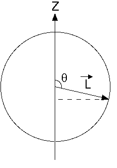

The vector model of angular momentum is a mnemonic device which illustrates the quantization of angular momentum and the restriction that only one of component can be specified. By convention that component is taken to be in the z direction. The figure below represents an example of the vector model. The radius of the circle has a length of 3.653 x 10-34 J-s.
a) What is the orbital angular momentum quantum number, l, represented by this figure?.
l = 3. *
OK
As shown in the figure the angle between the z-axis and the angular momentum vector, θ, is 106.779°.
b) What magnetic orbital angular momentum quantum number, ml, does this orientation represent?
ml = -1. *
OK
c) What is the projection of the angular momentum vector, Lz, along the z-axis in units of J-s?,
Lz = J-s.
-2.872276 NO
Other allowed values of the magnetic orbital angular momentum quantum number would be represented in the diagram by other vectors.
d) Following the rules of the vector model, what is the total number of vectors that could be drawn in the figure.
The total number of allowed vectors is 7. *
OK

I am having problems calculating L in part C, which I will need in parts E and F. I have tried a couple of different equations and I am not getting the right answer. I would have included a relevant equation and some of my work but it covers nearly two full pages of wrong answers. I am terribly stuck!
Thanks for all the help.
I was making Part C harder than necessary.
Lz = -1.05455e-34 Js
But now I am stuck again on parts E and F. I am having problems calculating the potential energy based upon my information.
