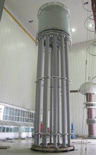

i don't know for sure but would bet it has to do with the smoothing reactor.
Reason i say that is 350/220 falls between √2 and √3 ,
and I remember from high school that a choke input filter has better regulation.
Here's a picture of a smoothing reactor
and a link to Siemens - perhaps there's a tutorial there.
http://www.energy.siemens.com/us/en/power-transmission/hvdc/
page 8 of this pdf looks like a start.
http://www.energy.siemens.com/us/pool/hq/power-transmission/HVDC/HVDC_Proven_Technology_.pdf
(if link doesn't work, i reached it by clicking on "HVDC Technical Compendium" here:
http://www.energy.siemens.com/us/en/power-transmission/hvdc/hvdc-ultra/dc-components.htm )
