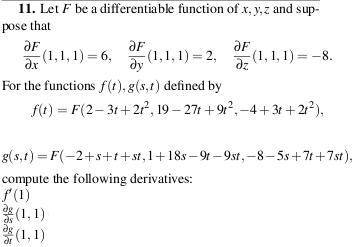

Find f'(1), ∂g/∂s(1, 1), and ∂g/∂t(1,1).

The problem is attached.
The correct answers are:
f'(1) = -68
∂g/∂s(1, 1) = 14
∂g/∂t(1, 1) = -136
Differentiation and partial differentiation.
I'm at the f'(1) part. I differentiated each component of F(2 – 3t + 2t^2, 19 – 27t + 9t^2, -4 + 3t + 2t^2) to get f'(t) = F(-3 + 4t, -27 + 18t, 3 + 4t) and then f'(1) = F(1, -9, 7). I'm not entirely certain if what I did is correct so far. If it is, what do I do next? If I omitted something important, tell me.
Any help in solving this problem would be greatly appreciated!
Thanks in advance!
Looks fine to me.
Now differentiate the components of g(s,t) first with respect to s, then with respect to t, and plug in (1, 1) just like before.
