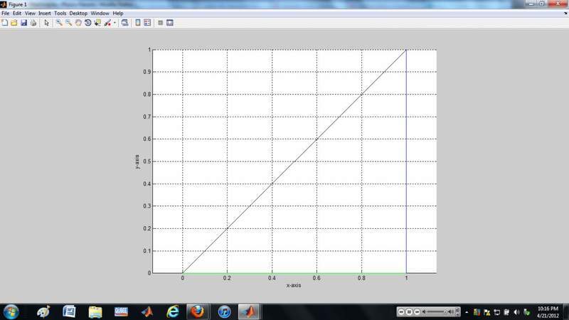

Um. I tried visualizing it and I even drew a graph of the three curves in Matlab. Now what I found was that the curves intersect at (0,1),(0,0) and (1,1). Attached is a screenshot of the graph I plotted in matlab. Now these coordinates of intersections mean that the lower limit of x is 0. However when I evaluated the answer it came out to be wrong. What am I doing wrong? Is my lower limit of x even right?
Again don't tell me WHAT the limit is, just tell me WHERE and HOW am I going wrong?

Your screen shot shows a single line. The graph of [itex]y= \sqrt{x}[/itex] is a parabola. The top plane, z= x+y+ 1 crosses all three boundaries, y= 0, x= 1, and [itex]y= \sqrt{x}[/itex] above the xy-plane, so, as far as the x and y bounds are concerned, you only need to look at x and y.
Now, looking only a the xy-plane and the region bounded by y= 0, x= 1 and [itex]x= \sqrt{y}[/itex], what are the smallest and largest values of x? For each x what are the smallest and largest values of y (the answer depends on x, of course).
Then, in three dimensions, for each point, z goes from 0 to z= x+y+ 1.

The smallest value of x would be 0. Right, since x=sqrt(y) and is bounded above by 1 so since the lowest value of y is 0 so x=sqrt(0)=0 thus the lower limit of x is 0.
Geomterically this also makes sense. I plotted the three curves on a piece of paper. The three points at which the 3 curves intersected each other were (0,0), (1,0), (1,1) so
largest value of x=1; smallest values of x=0
" " " y=1; " " " y=0
