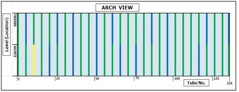

Hi Friends
Can anyone help me with m-file for the subject below
I have an Excel data sheet Which give Thickness of several pipes on 5 Different heights and I want to plot each bar is for one pipe with 5 values in 5 Different heights and give A different color for Thickness range
example
my heights values is on 25cm ,50cm , 75cm .100cm , 125cm On this heights I read
first pipe Thickness 3.07 3.11 3.18 3.05 3.06
seconde pipe Thickness 3.09 3.1 3.11 3.09 3.08
third pipe Thickness 3.14 3.15 3.13 3.08 3.05
So I want plot one bar for Each pipe and give A different color to Each Thickness range At Each heights
many thanks for all

I'm not familiar with "m-files". If you are doing this in Excel, wouldn't it be a *.XLS type file?
Can you show a screenshot of your plot attempts so far?
An m-file is a script file for MATLAB. He is probably using MATLAB's built-in function that reads in Excel data.

thanks for reply
yes it's filename.xls file but iwant use MATLAB to plot it
Here is my data in Excel sheet:

And the attachment pic was made by MATLAB from the Excel datasheet and my asking is how to make M-file to give this pic.
