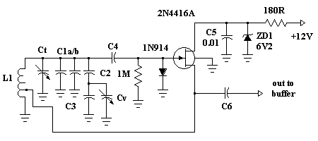

Relaxation oscillators do not produce continuous sinewaves.
Typical sinewave oscillators would be Hartley and Colpitts oscillators. These use tuned circuits with varying methods of connection to a transistor or FET.
Here is a Hartley oscillator. Ignore all the capacitors at left. These are just to get fine tuning of the oscillator.
Only one (say "Ct" ) is needed.
You can read the whole article that this circuit came from here:
http://www.hobbyprojects.com/H/hartley_oscillators.html
There is a link to this site:
http://mysite.du.edu/~etuttle/electron/elect16.htm
which gives a summary of the different kinds of sinewave oscillators.
